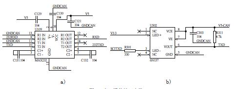

the serial interface is isolated by optocouplers:

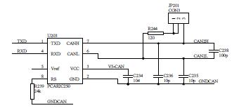

CANbus interface:
I am interested to use CANopen in an EnergyBus configuration (see e.g. here p179ff)
In the OZ890 Datasheet a reference is made to The Application Note "OZ890 AN-11: Application circuits for 5~13 cells Li-ion battery pack" describes
the typical application circuits for 5S, 6S, 7S, 8S, 9S, 10S, 11S, 12S and 13S cells Li-Ion battery pack
(see p7). I wonder if this isn't the Smart BMS S5-13 ? Has anybody found this AN-11 somewhere? r
