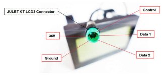

This is the pin out for a KT 4n1 Harness with the two pin red brake connectors..There is a center pin in some controllers, used for a light on a 5n1 harness.
Shows the output from the controller, as well as the cable.
A throttle would connect to Ground, plus the two throttle pins.
The display uses the green connector and five pins.
You can check your harness for the same pinout to the disp[ay,
So my display has the same Julet 5 pin connector as in your pic. My 8 pin harness looks exactly the same too. Everything should be plug and play except the Pas. The 3 pin plug from the bike is a female and so is the one from the controller. I purchased a male to male Julet 3 pin cable so I can connect them. I’ll give it a try later today, thanks.

What display are you using though? Only a KT display works with a KT controller. Other displays may be able to power up the controller, but they can't change PAS levels or read the speed, Throttle and a basic PAS often work though, unless the foreign display gets upset that it cannot understand the data from the KT controller and shuts down,
