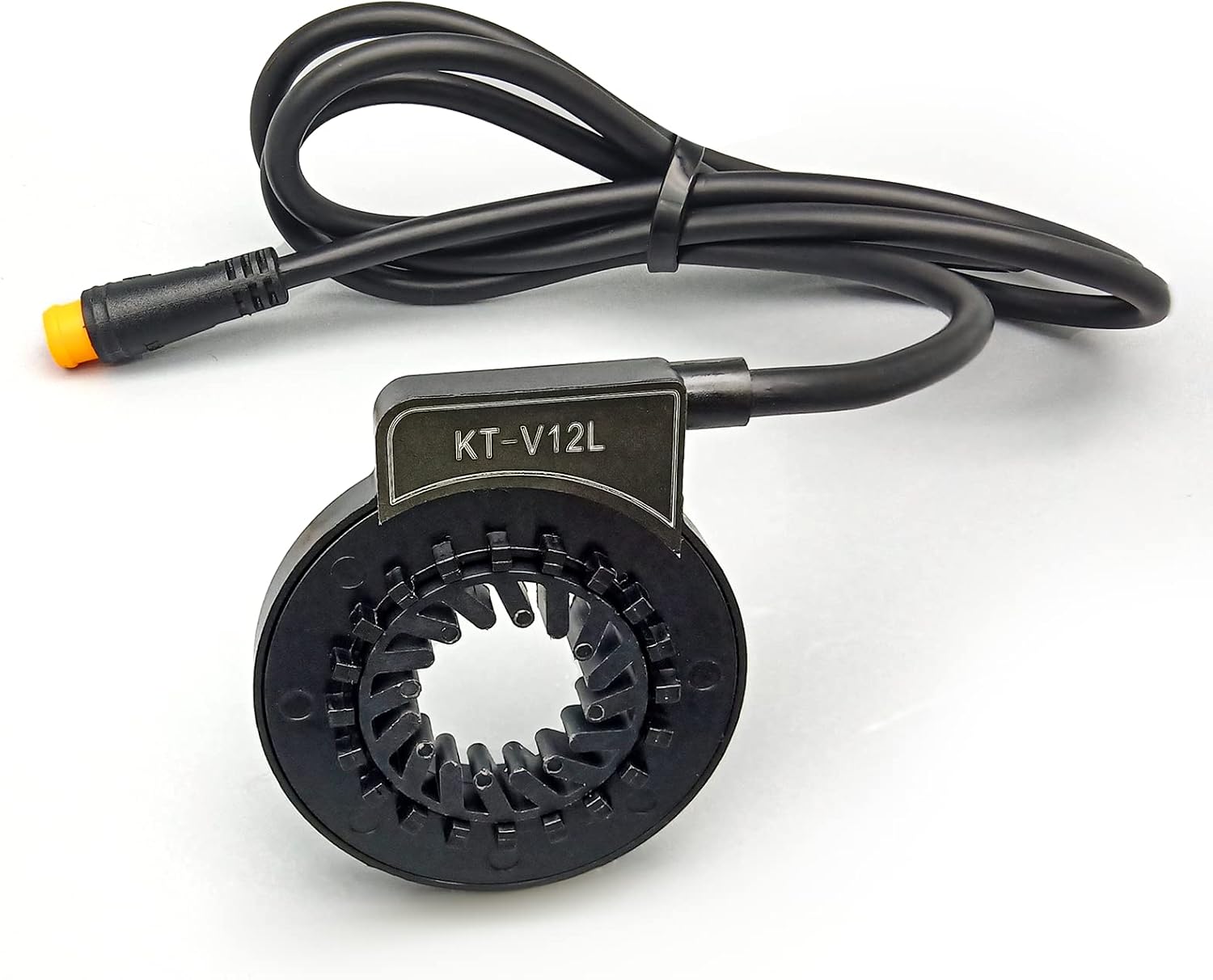

I've found one kit on Amazon that I think might do the trick. Amazon link It has the controller, pas sensor, display, I looked again last night at the bike and the output cable. The only existing connections I have to use are the output to the motor and the DC in and that is just 2 wire. There are no brake switch inputs since it was a torque sensor crank and as long as you stop pedaling, the motor stops instantly. I'd rather order off Amazon than Aliexpress, If I have problems, returns should be much easier.
I'm thinking I can hook this up for testing first without cutting any of the existing wiring and see it work. I gotta keep in mind that I'm not the end user and that it has to be pretty seamless or I'll hear about it for a long time. If it doesn't work well enough, I want to be able to put it back as it was and tell her I gave it a good try. Lots of these offerings seem to have the same parts, the controller in this case has speed misspelled as Speet and that pops up on more than a few I've seen.

The multi input cable was a bit bigger than the opening that the old cables went through so I had to break out my old pneumatic filer and open the hole up a bit. Since its an aluminum frame I'm not too worried about corrosion, but I'll do my best to seal it up.
I tried to mount the pas sensor on the inside of the locking ring which mostly worked, the magnetic pickup slightly bent, but when the magnet ring is on and the pedal is back on it is too tight to turn. Any idea of an alternate way to mount it?
I need to order an extension for the 9 pin motor connector. The one on the controller is just too short, but hopefully I'll have this done soon. Thanks for lookin.
Bend the metal ring perpendicular to the sensor mount part of the bracket, so it would sit under the BB shell, and secure it to the BB shell so that the sensor still sits where it is now. You can use whatever method of securing it that works for your use-case (zipties, epoxy, gorilla-glue, duct tape, etc).
Or you can fabricate a bracket (metal, plastic, etc) that allows you to mount the sensor like that, and secures to the underside of the BB to the derailer/brake cable guide plate / screw.
But if the rider is going to use the throttle, you don't even need to install the PAS sensor.
Remember that for nearly all systems, the cadence type PAS sensor doesn't give control over the system, it just turns it on at full amount of the assist level presently chosen, if there is any pedalling. It doesn't measure the pedalling speed or pressure, it just goes.
