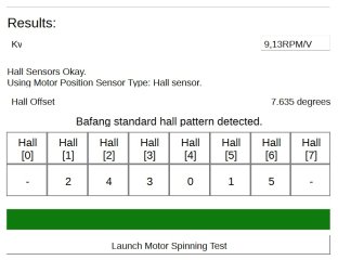

I recently purchased a second-hand Phaserunner v6 (L10) + Cycleanalyst and I am in the process of upgrading "The Mule" - a HEAVY frontload cargo bike - mostly in hope to improve its performances (peak mechanical power especially critical right now, hopefully improved through much greater efficiency) and functionality (especially electric breaking and regen).
This vehicle is mostly used in and around Cévennes (moutaineous range in France) : for commuting to the nearby city (40mn drive, and a challenging 400+ 6-8% ascent when cycling back fully loaded with two kids and a week's supply of groceries ...) and locally, for some beekeeping operations.
Currently, it is powered by a CSC rear wheel hub motor with unknown characteristics and driven by an equally unknown but particularly large Chinese controller (by chinese controller standards, and because it has let 2kw through for several rather extended periods of time, when CSC replied to me that they don't do controllers over 1.5 kW ...).
Yesterday, I managed to get the wheel spinning with the autotune feature but I already have two questions :
[1] is it possible that the autotune gets the motor to spin with wrong KV and pole pair settings ? How can I know if the motor is being driven (non-)optimally ?
[2] altough I have been very cautious with wiring, the autotune process concludes "No valid Hall signals. Maybe the hall cable is disconnected." No information in the "Detected Hall Pattern" table. Besides hardware failure and wiring error (which I will be checking next), what may be the cause of such a diagnosis ?

I took time to re-check the wiring using a different method and re-did all the soldering.
The autotune process went through and all my Hall sensors are now detected ! I am not sure what went wrong initially ... (As none of the halls were working, I assume that the 5V circuit was somehow cut).
I've emailed GrinTech a few hours ago to ask them to have a look at this thread to get a reply about my first question.
As a basis of the next steps of the setup process, I paste below the output of the autotune :
Kv = 9,13 RPM/V
Hall offset = 7,635
Number of pole pairs = 23
Rs = 76,0mOhms
Ls = 182,0uH
I've attached a screen capture of the hall pattern.

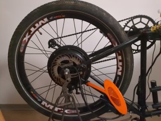

I've attached a picture of the engine. Let me know if any other photo detail can be useful.
The motor's casing is roughly 220mm in diameter, and 65mm in thickness (external dimensions).
It has also just been statorade-injected.
The picture also features a small torque arm. I am in the process of thinking through a much stronger DIY clamping torque arm that would replace the bolt on the left side. I've browsed the relevant pages on the forum, that gave me several ideas, but specific suggestions from people experienced in the 2kW range are welcome.

Looks like ya typical 9C clone.
Consider an ebikes.ca clamping torque arm if the task of making your own is too hard.
It would be very hard to do a better job.
..and then put the current weak-ish torque arm on the other side.
40A batt / 100A phase is a nice place to start for a 9C clone. But watch the heat :)

I was suspecting it might be a RH212 clone. I've read somewhere there are two versions, and I'm hoping it's a torquey slow winding. Does that make sense ? It would be a nice confirmation, as this was the low-budget option with best performances given my needs, based on Grin's simulator. Any way I can identify/confirm the specific model it has been cloned from ?
Regarding GrinTech's torque arm, I've considered it but I am on a very low budget atm and this build may only be a prototype or an earlier version of an improved cargo bike, as I have some concerns with the frame (mostly functional, possibly structural).
Also, if I upgrade the motor, I will preferably go for one with an integrated torque arm (currently waiting for Heinzmann or Grin second hand motor opportunities).
I would invest in Grin's torque arm right away if it could be transplanted (as a redundancy, for moving it to another motor or frame, for selling if I end up not needing it) but that is not the case in their design.
And I prefer, as much as possible, rigging solutions that could be fixed in case of failure in places where there are only basic tools.
The TA is entirely portable, and trivial to uninstall it and transplant it to another motor, frame, or bike.
The Grin clamping TAs are installed and adjusted with common basic hand tools common to basic bicycle assembly and maintenance.
Not without taking it apart and showing it's guts. If you have a programmable controller, it might have a 'poles' setting set, that would be helpful because this motor is taller and has more poles than a typical 9C clone.
>95% of hub motors are 9C clones, and this looks a lot like one from the pictures.
The ~$70 part is a lot cheaper than replacing a $200-$5000 bike because the dropouts got ruined from high power. Worth every buck.
I get why you would hesitate.
Unfortunately two cheap and kind of loose torque arms ( 1mm of play is too much, if you don't have to hammer the torque arm a bit onto the axle, it's not doing a great job ) has less motor holding ability than a single one of those due to the clamping action.
I would only run them short term.
