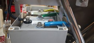

I re-connected the phase wires and when I wanted to switch on the main power, there was a huge spark under my controller cover.
Opened it, and it looks now like this:
The fuse is still unchanged, but the controller seems to be dead now...
WTF is happening?
I didn't change anything except diconnecting the phase wires yesterday, and connect them again today.
Just for comparison-this is what it looked like before:
Yes indeed before burning it was not burned...Now the motor is stuck right ?
There should be a mass on the blue phase.
It looks like a ground or a wire with another voltage has shorted here.IMG_20220616_150133.jpg
You didn't forget to remove the 13 key to tighten the phase before powering up? :roll:
No way- I even had closed the cover before switching on !
There is/was no lose cable inside the controller box, and no tool either.
I dont understand from where those small balls of melted metal come from.
And the motor(sprocket/shaft) can still be moved by hand, it feels the same as before.
It's really very strange because to make a short circuit at this level it is absolutely a piece of metal between 2 phases or between the phase and the mass of the frame of the motorcycle for example. If the motor is not blocked it is surely that the controller is not in short circuit, but it would be necessary to open it to see inside, if there is damage. A friend of mine had a problem with a brand new 600A Kelly controller that cost over $1200. The controller burned out on first power-up. There was an internal short between +5v and +VCC.

This (ground wire problem) might be proven by the most recent incident ?
(see above-a flash at the controller's blue wire inside the closed controller box when switching it on)
But where?
Inside the motor?
