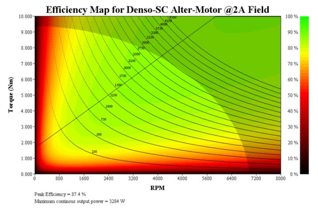

I can't find the thread I'd mentioned earlier on using an alternator as a motor :/ It might be on a different forum but all my searches are coming up blank so far, hope it's not gone for good as there was some really good info in it. Here's some of the dyno charts from it, iirc he was running a standard 12v alternator at 60v for them:
Over 3kw continuous, not bad at all for something that can be bought for less than $100 new and little or nothing used and iirc he was confident around 6kw continuous would be possible with a modified alternator. If you're looking for more power then your batteries are by far the weakest link imo, for mobile applications lead acid batteries are only useful for keeping wheelchairs upright. The main reason is their capacity is nowhere near its calculated value, Ah x volts:

Wow thanks Stan, those charts really show the efficiency changes with those field current inputs.

Yes, there's way more variance from changing the field current than you'd expect. The first time I hooked an alternator up with a variable power supply on the field (LM317) I was almost afraid to run it up to full speed, they'll often run at over 20,000rpm under the bonnet but it's scary to see one doing half that on the bench!
