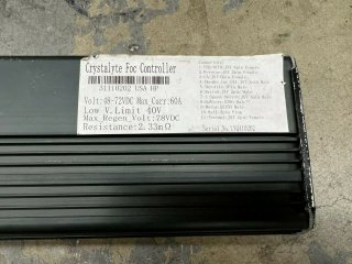

I've been looking for another controller that will either go with my existing motor when it gets transplanted to a new project, or to go with my new Leaf motor once I finally get around to upgrading my current bike. Similar to the current PowerVelocity controller, I wanted it to be sine wave, decent current, and a flexible voltage range. Regen and push button cruise control options are nice-to-haves.
I spotted this last night and decided to take a chance on it and picked it up for the $95 I offered:
It looks to be something similar to the 18FET version here:
https://ebikedeal.com/controllers/
or here:
https://kobois.com/index.php/product/crystalyte-controllers/
Here are some questions for anyone who knows about these Crystalite controllers. I read a couple of thread on the forum already.
  • The voltage range of 48V-72V seem to be the nominal voltage ranges, so 13S to 20S. One part of the listing says max input voltage of 78V, which I think may be tied to the max regen voltage. My guess is it will go to the 84V of a 20S battery, but I plan to open up the controller and check the caps and fets unless someone confirms the ratings to be nominal battery voltages.
  • The label says it supports regen up to 78V, and I noticed that the brake switch connector has 3 conductors. I'm wondering if the controller is capable of variable regen.
  • For the thermal JST connector, I'm wondering if that's an input or output (input from thermistor in the motor, or output from one in the controller).
  • Any idea where to get the software or hardware for the USB programming connector.
  • Any idea about the phase amps the controller is capable of. I'd be moving from 70A battery/200A phase current, to 60A battery, but I usually only see 60A now under acceleration anyway.
It looks like the LVC is 40V, for the 13S voltage, and if everything is unconstrained in the default settings, the controller should work fine for my purpose, without having to access any program settings. The controller has a CA connector, so I may only need to run the CA cable, plus the on/off and 3-speed switch cables to the handlebars, so a fairly clean installation. Anyway, seemed like a decent deal for 72V 60A sine wave/FOC, so worth taking a chance on. If it's genuine and has the 4115 FETs, then that's even better. No cruise, and I don't like the CA auto-cruise, but I'll live.
Probably not, but if it is true FOC, then it might be. However, it probably does this via the throttle like slip regen (if at a high throttle position, moving throttle to lower position causes braking to slow to that level; letting go of throttle completely doesn't brake to a stop; you'd turn it down slowly enough to cause braking effect instead), or done like the Grin method of engaging brake lever and then the throttle controls braking amount instead of motor power amount.
If the brake connector reads 0v on both the signal wire and the ground wire, but 5v on the other wire, then it is more likely to be a throttle-style input for variable regen, and you can connect a throttle to it to see how it behaves.
If it reads 5v on two wires and 0v on the ground wire, then it is probably just a switch input, and is just capable of powering a hall-sensor type of brake switch (not common, but they're out there, like the HWBS inline-cable type, or the ones that came with my Fusin kits, etc). These do the same thing most two wire brakes do, which is to just ground the signal line to activate the brake. Easy to test. You can also put a potentiometr between the signal and ground and see if it reacts to variable input, but if it's 5v (rather than 0v) on the signal that's unlikely.
Almost certainly an input from the motor. There's no reason to output anything from the controller, as the controller itself would be able to do it's own limiting / protection if it has it's own internal temperature sensor.
If it's been modified by a previous owner to work with the Cycle Analyst, etc., then it might have an independent thermistor, but you can trace that out when you open it to check FETs and caps.
If there is any, it would have to come from Crystalyte. If they don't have that on their website, you'd need to contact them. If they dont' respond, you could check with Crystalyte dealers (if there are any) to see if they have it. (I've never run across any myself).
My guess is it's something around the same ratio, but unless Crystalyte has the specs, you might only be certain if there is setup software for it and it has a setting for that you can access.
True FOC controllers should be monitoring actual phase current, so there should be current sensors on at least two of the phases (preferably all three), so if you can find out what those sensors are, and the scale of their output, you can make a monitoring system to actually read what the real phase current is, realtime. :)

Based on the label and the similar 18FET controller from the link, it looks to come stock with the CA connector, so now I'm wondering if I connect the thermistor from the motor to this input, if it would feed the info to the CA though the data conductors, of if I need to wire to the CA separately via the temp sensor plug.
There is no data communication of any kind between the CA and any controller. (not in the sense that KT / etc types communicate with their displays)
The only connection between them in the common 6pin JST-SM "CA connector" are the two shunt wires from controller to CA, battery positive and negative from controller to CA, a throttle signal from the CA to controller, and a hall signal for speedometer from controller to CA. No "data conductors" exist.
In the phaserunner/baserunner waterproof wiring for the CA, there is also a thermal sensor wire, IIRC, but that isn't present in the JST CA connector that you would typically find on "CA compatible" controllers.
If you prefer the CA to do the monitoring and rollback based on motor temperature, and don't want the controller to monitor motor temperatures and do it's own rollback per however it is designed and setup, you could cut the thermal sensor wire from the motor and connect it instead to the CA's temperature sensor input (assuming your motor has a compatible sensor).
I don't know if the electrical design of the controller's temperature sensor input is compatible with teh way the CA's temperature sensor input works, or if it will screw up the readings for both of them (or even damage one or the other, though that is unlikely), so unless you know it will work to hook it up to both, it is safer to just use it for one of them. If you need sensing for both, it would be safest to isntall separate sensors in the motor for each.
BTW, there are series of Crystalyte controllers that use their *own* display system (like the KT, etc type controllers do) that use a connector that *looks* like a CA connector, but is not, and is not wired the same. I think they even called it a similar name, at least when they started out using them--don't know what they do nowadays. Not knowing what voltages are present on the Crystalyte display connector and on what pins, I don't know what would happen if you plugged a CA into it--you could fry the CA if battery voltage is present on the wrong pins. :(
So be very sure that it really is a CA connector (and not that it is just labelled as such), by verifying the actual wiring inside the controller, before you plug one in.

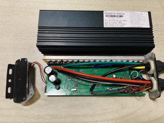

The controller arrived and the first thing I noticed is how light it is, and smaller than expected. My 18FET KT controller is a little bigger and has more mass, and my 18FET PowerVelocity controller is much more hefty.
Opened it up to take a look. Silicone seals on the covers, plenty of thermal grease, but pretty sparse inside.
Looks like it's set up to handle the rated current
The larger caps are 100V, and smaller are 50V, including one tiny one on the back of the board. No bulging or signs of problems. The listing did say it's a New* unit.
The "Thermal" JST is actually on the motor harness, so more likely an input from the motor thermistor
In the controller it terminates on the main board. This makes me think the CA connector may be capable of transmitting temp signal, perhaps another option to the thermal JST coming out of the CA. CA docs don't say it can, but this controller is supposed to only work with a CA. Looking at the circuits on the back of the board, one wire seems to go to ground and the other over to the MCU.
Also, it looks almost like there's a thermistor attached on one of the FETs, but hard to really tell. The FETs themselves don't seem to have any markings, at least looking at them using the magnifying app with light on my phone.
To me, it looks like it could be a decent unit, but wonder if the light weight will be a factor, since there's less mass (or fins) for heat dissipation. I ordered some XT150 connectors for the phase wires so I can test it out, and will probably replace the Andersons that are on my PV controller so I can swap it back later if I fry this one.
The heavier ones may use a denser aluminum for the case and FET moutning bar (which AFAICR will generally conduct the heat away better), and / or busbars of some type on the battery/FET busses, or even a heavier-copper PCB. This one has at least thin busbars on the battery busses to teh FETs, visible in the pic of the bottom of the PCB. They look like copper; cant' tell thickness. 1mm?
That's actually "bad". You only want exactly enough to just barely fill the scratches in the mating surfaces, so that the metal itself makes all contact possible, and the thermal grease only fills places where air would have been (because air is even worse at conducting heat than thermal grease is).
If the mating surfaces are so bent or distorted that they require visible thermal paste to make a heat path between them, rather than metal to metal contact, that's not very good. You can improve it by lapping them together but it is probably not worth the effort for a "little" controller like this. ;) For a hefty controller for multi-kW applications, it might be.
Never heard of that "Chanox" brand, or "Huahong"; if you do have problems I recommend replacing with Rubicon or Panasonic, from a distributor like Mouser, Digikey, Farnell, etc. (ebay, and the like have plenty of fake/remarked/defective/scrapped parts of all kinds, and without a test lab you can't know if the parts you get are the parts they say they are). Get the Low ESR versions of whatever you do get, in the higher temperature ratings (at least 105C).
I've never seen anything (at least in non-Grin-Tech-designed hardware) that can pass a thermal signal thru a "CA connector".
If the CA connector is a 6 pin (usually JST, nowadays I think they use Higo on the WP models of CA), then it doesn't have a wire for any temperature sensors. It only has shunt + and -, Battery + and -, Speed (one of the motor hall sensors), all five come out of the controller to the CA, and the only input to the controller from the CA is the Throttle wire.
The CA's temperature input is a separate connector.
Most likley the controller monitors motor temperature so it doesn't damage the motor (same reason you can do it with the CA). You'd have to check the setup program for it, or it's specs, from Crystalyte. If it doesn't have a setup program, you would probably ahve to have one of Crystalyte's APM displays to change it's settings.
SInce the CA doesnt' do anything required by any controller, you can use the controller by itself just fine. If it is "made to work with a CA" it just means it *can* work with a CA, in that it would have the CA-specific-wiring of the signals I listed prevously on a connector the CA can connect to, so you don't have to use the external shunt and speed sensor on the CA and separate throttle connector from CA to controller. (which is what the CA uses when there's no CA-specific connector).
Certainly possible; that would only be read by the controller for it's own purposes, and not be available for any outside uses.
There's a separate throttle cable which is also HiGo, which makes me wonder if this controller is of the same vintage as the CA 2.4, so the connector carries a throttle override signal. If so, I think I may need to add a diode or 1k ohm resistor to the controller board so it works as a throttle input. :shock:
If it's new enough to use higo connectors, it's unlikely to be a CA2.4 wiring setup; that was quite a long time ago. ;) If it was that old, it would probably have all JST connectors, and Andersons on the phases and battery (all the ones I've had did).

I finally reopened the controller to trace the CA connector wires and throttle wires. They use some odd color combos. The throttle cable uses white to ground and black as the throttle signal, for instance, which caused some confusion, making me triple check.
Even with the couple of HiGo connectors, the controller still seems to be on the cusp when it comes to when it was made. The clue I see that there's a 1K resistor in series with the CA throttle wire and the throttle input on the board, which I believe was needed for pre CA3, when adding a CA connector to a controller. Either it's pre-CA3, or the resistor is there for backward compatibility. I'm thinking of bypassing the resistor and see if it works that way or if it makes any difference.
The resistor from the CA connector terminated on the SP point on the board. Interestingly, the throttle cable (black) that terminates at the same point, also appears to have a resistor in series, although I haven't peeled off the shrink wrap to see what resistance is there yet.
