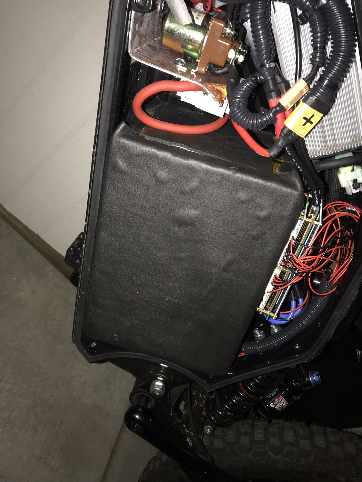

Well it’s done. Just need to make me a bracket for the BMS to hang above the battery. Or I’ll just strap it to the battery maybe.

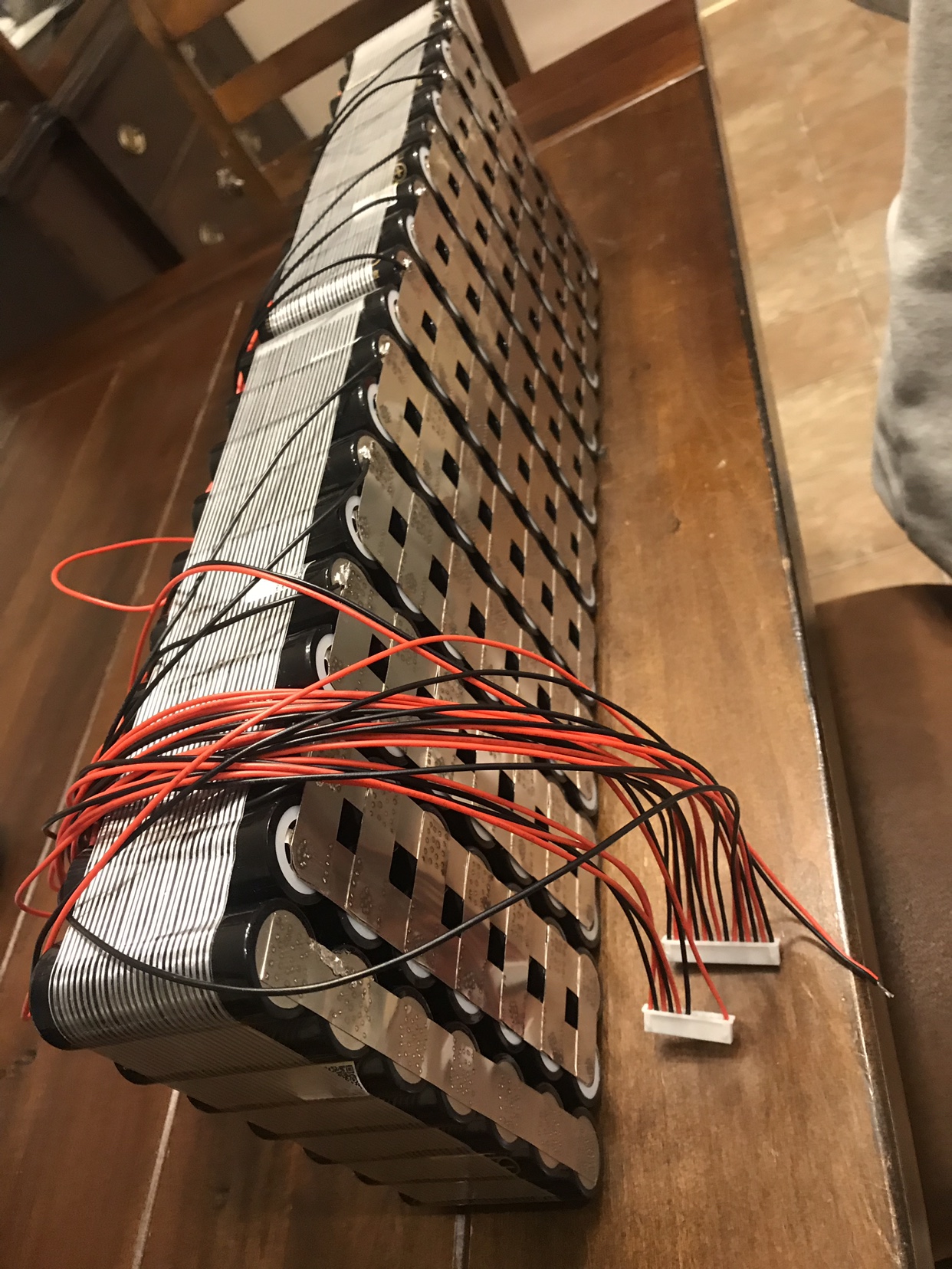

I only took a few pics during the final stages as I was trying to get it done and forgot to document the last few steps. Pretty much folded the pack in half after I put on my nickel plates with soldered on 6ga wire. Used a torch and some solder...that worked well. It’s not moving. Lol. The. I spit welded those strips with cable on them to the battery ends. So it has the full length of the battery parallel group and cable runs the length of it as well. Wrapped it up in a mile of kapton tape and the neoprene padding. Almost looks like a professional pack. [emoji12]
Maybe in the future I will shrink wrap it. But for now it’s a very snug fit. Just gonna leave it alone as it works to be tight inside the frame.
Took it for a little ride at 75.5 volts it dips down to 60 when full throttle is applied for a bit. So sag is there but performance is bang on. It scoots like crazy and feels great. Nice to have the capacity.
