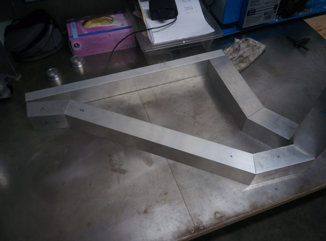

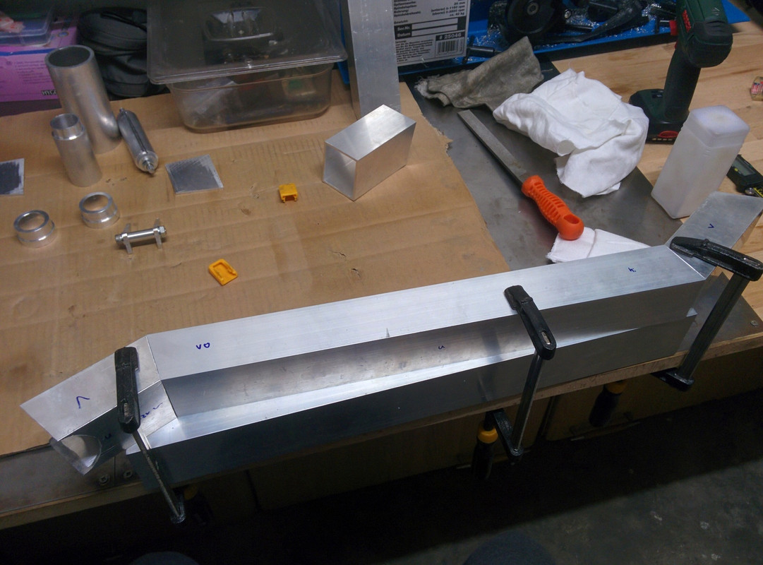

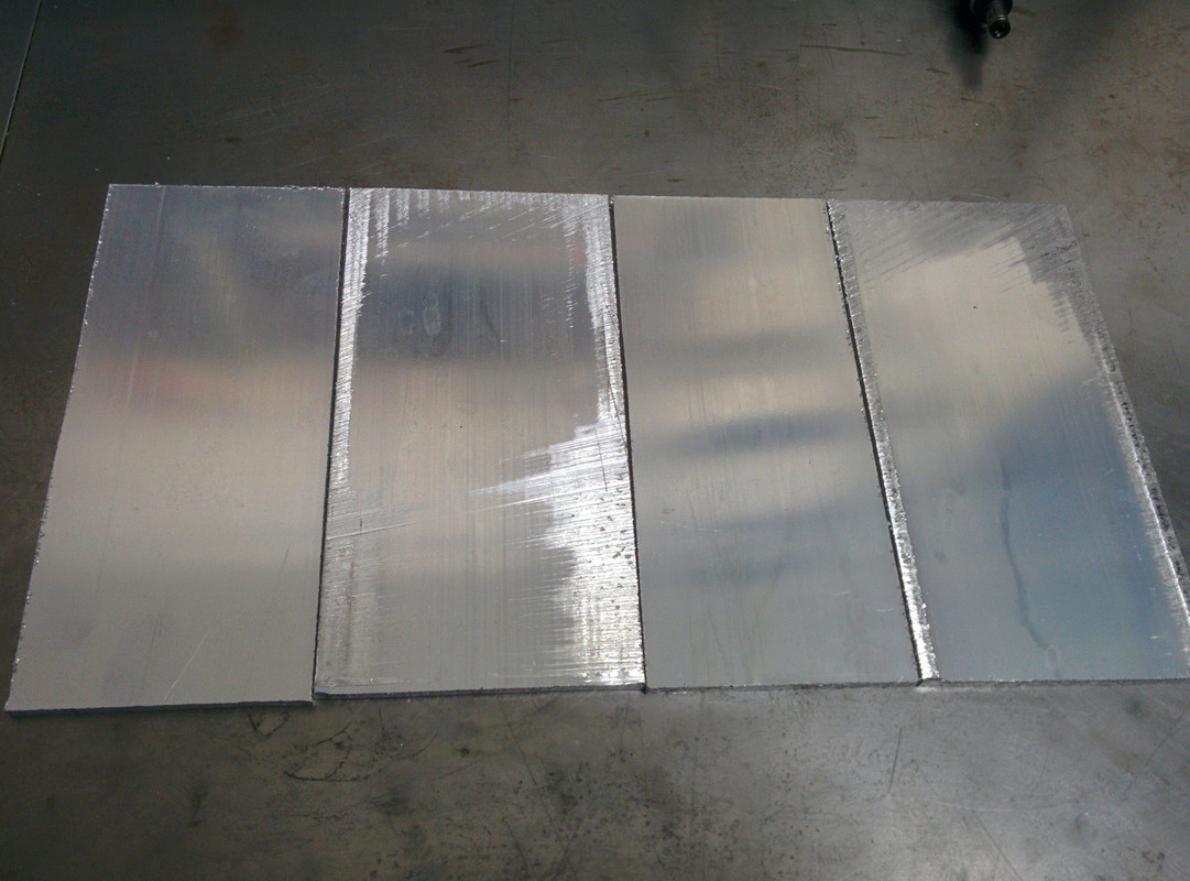

NEW UPDATE:

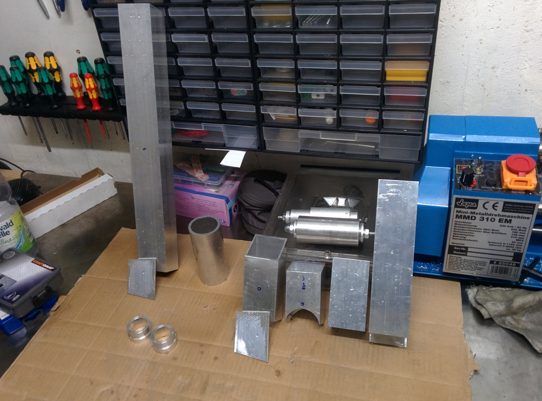

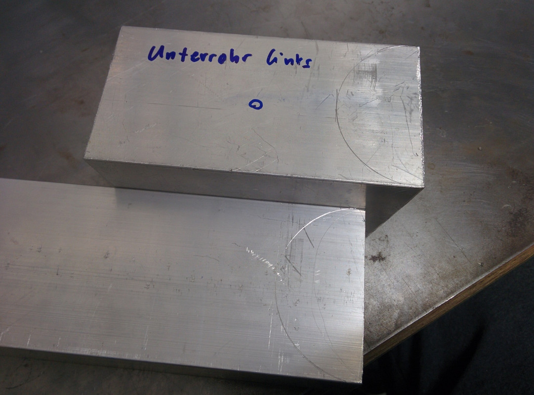

Today, I was in the workshop for a couple hours, and managed to cut nearly all the parts for the frame. Its really important to cut as precise as possible, otherwise welding will be horrible. (And germans like precision :D)
Its always good to have good lights to work with. A 360 degree arm with a super bright light and a magnatic stand is just so perfect for many applications. More than i noticed before even building it :roll:
Then I started to build the heatsink for the headtube welding, otherwise it would distort. Its just as simple as it is: a thick piece of aluminum turned down to loose-fit in the head tube, than a cut, and two cones that will be pressed into the heatshrink by a long screw, so that it will kinda connect to the headtube.
Pics of cutting:
Pics of turning:

First thing today was the heatsink for the seattube. this worked out quite good, better than i thought. Was about the same procedure like the headtube heatsink i made yesterday (and i figured out it wont work like that later..). But as I said, the seattube heatsink is perfect :)
These are the small cones is turned: (why is it so fun to turn cones?!) :D
And this is the complete assembly:
Second thing to do today was to mark the intersection with the headtube and top/downtube, therefore i had to line up everything properly first:

The headtube heatsink doesnt work. i think the aluminum tube is just to thick for the force applied by the cones. So tomorrow, I will try smt else.
The cone angle is 30 degrees at the moment, so my goal for tomorrow is to make 60 degree cones. these should put much more pressure into the tube, because they will take less force for driving them in. I was really annoyed when this didnt worked out as expected, cause its just 0.04mm in between headtube and heatsink. But hey, its still 10mm of wall thickness..i was to naive :twisted: :roll: :mrgreen:

The first thing to do, was to finish the heatsink for the headtube. I'm glad that this worked out pretty well, a 60 degree cone angle was way better than 30.
Still I had a problem: the cones where too short to hold them in the jaws and machine them, so i press fitted a round bar into the hole. I was feared this wouldn't work, but well it did.
Now the heatsink works flawless:

Last thing to do today was to align everything for the first time. I was very nervous..(would everything fit up well?)
But just see the result, theres nothing more to say :p afterwards I cleaned all the tubes for the first time.
