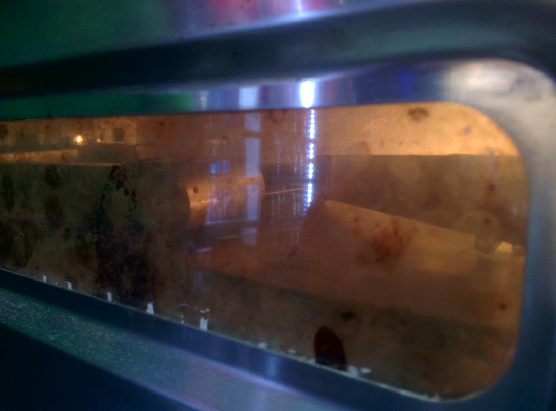

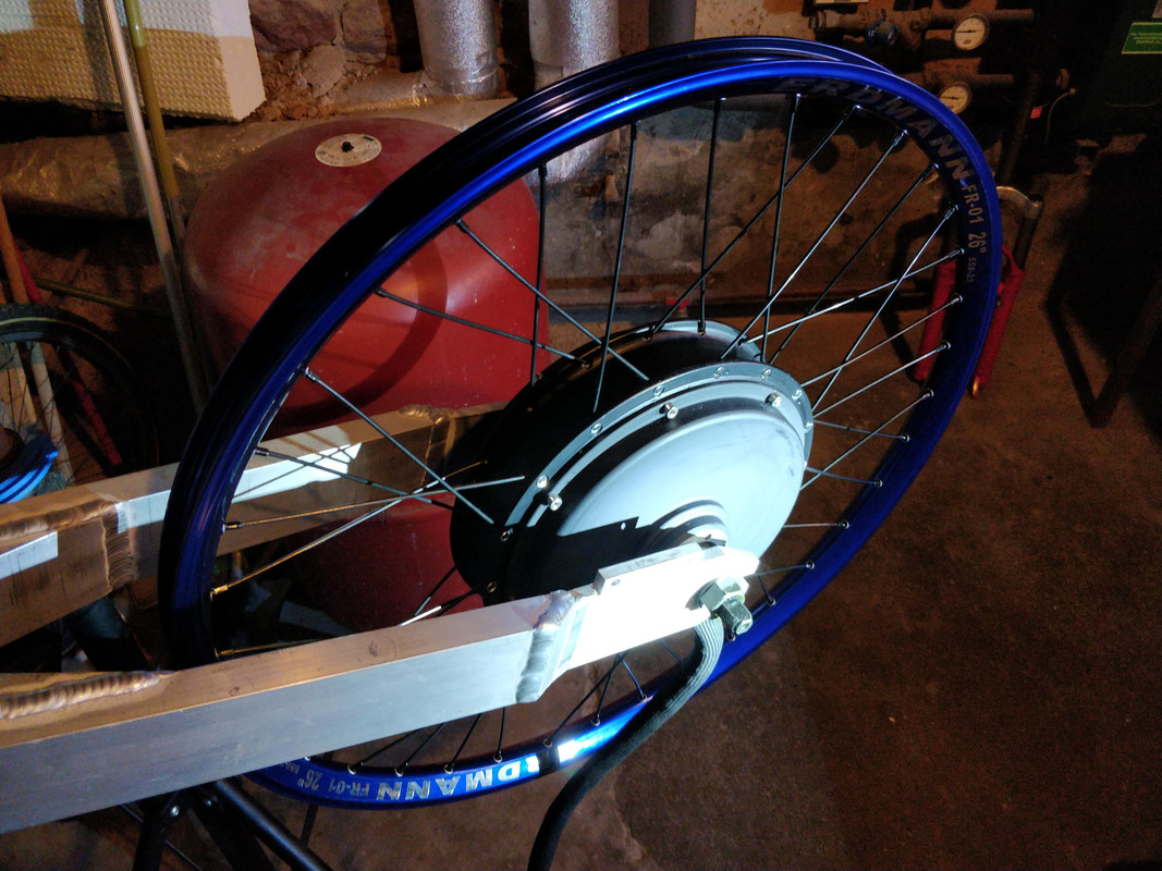

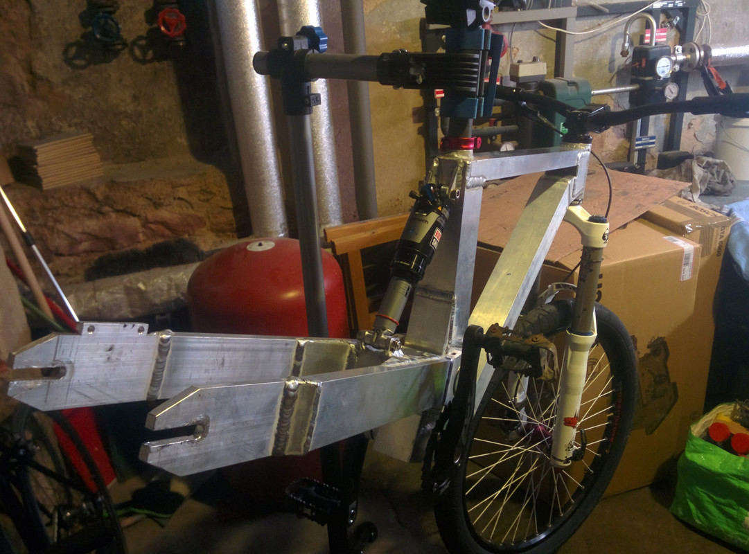

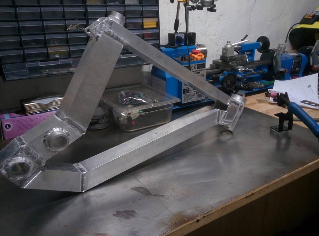

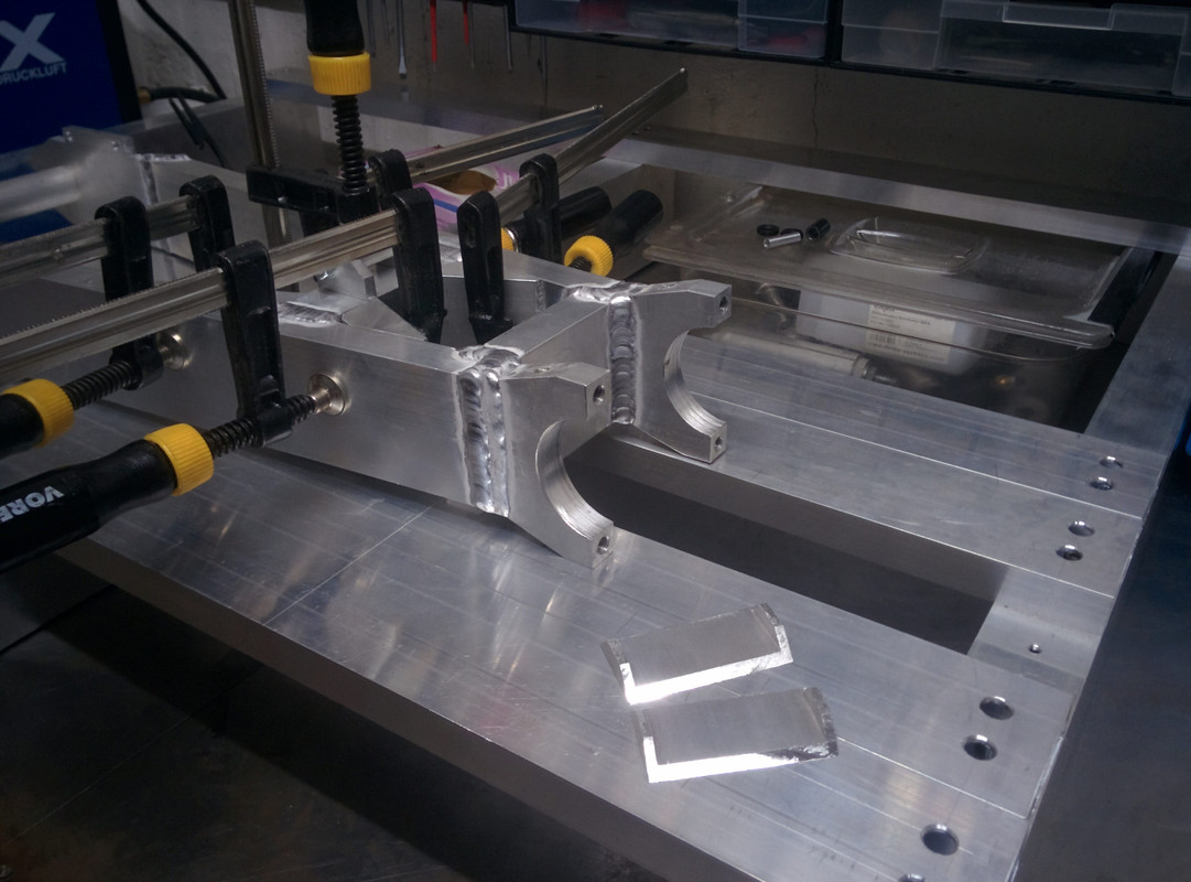

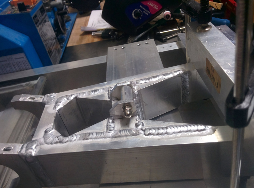

Hey guys, I'm sorry for not keeping you up to date. In the week after the kebab restaurant 500 degree heat treatment I've finished the T6 treatment in a big oven from a company that produces high-tech limb prostheses. It's always good to have some contacts. Now the frame is sitting in the basement waiting for its motor, but right now I don't have any time because of university. Right now, I'm in the middle of my practical semester at Bosch, had to move away from my hometown for still 3 and a half months.. coudln't take my workshop with me. On top of that, I wrote my pre-thesis with the topic "development and production of a 3-axis Gantry-CNC milling machine". The machine I developed is nearly finished, I just need to produce the last few parts, which I will do in the next semester. After this is done, I will finally build up the bike
I'm totally excited already
With the CNC-mill at home, I'll be able to produce better tooling for framebuilding or -of course- frame parts with nice shapes.. really looking forward to this. In any case i will keep you posted when somethings happening with the frame!

Got to love a kebob place down the down the street to toss your frame into for a quick heat treat. Best part of the story. If you round over the edges don’t go to far as the crisp edges define its minimalism, that I like. Please keep up the good work when you have the time. Will the swingarm fit a 27.5 inch x 2.8? Make inframe gussets that are also the motor mounts for the cyclone 3000 and this would be a hit. Please work on this idea for your next one, that i would be interested here in USA.
Yeah I really appreciate the kebab restaurant doing this for free! I won't round over the edges, because I also like the look and I think it makes the frame look unique and some kind of "prototype-looking". I designed the frame for 26" x 2.75" tires, but making another swingarm for bigger wheels is not a problem at all. Heat treatment is the only problem..

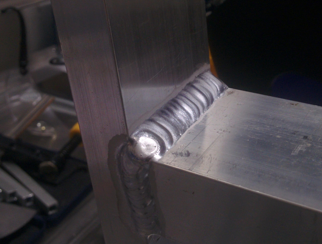

I hate to muddy the waters (heat treating can be a very volatile topic), but, I have never heat treated any of my aluminum frames. They have been fantastic without. This frame is so over built it would be fine without. That being said, if heat treating is an option, go for it.

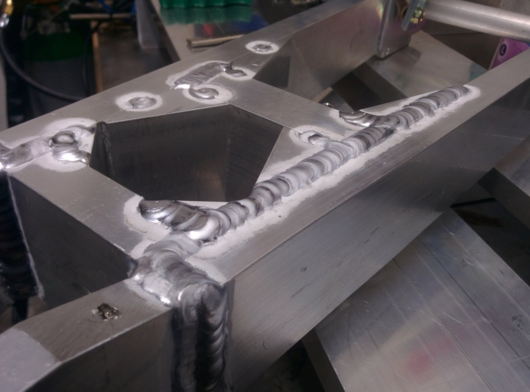

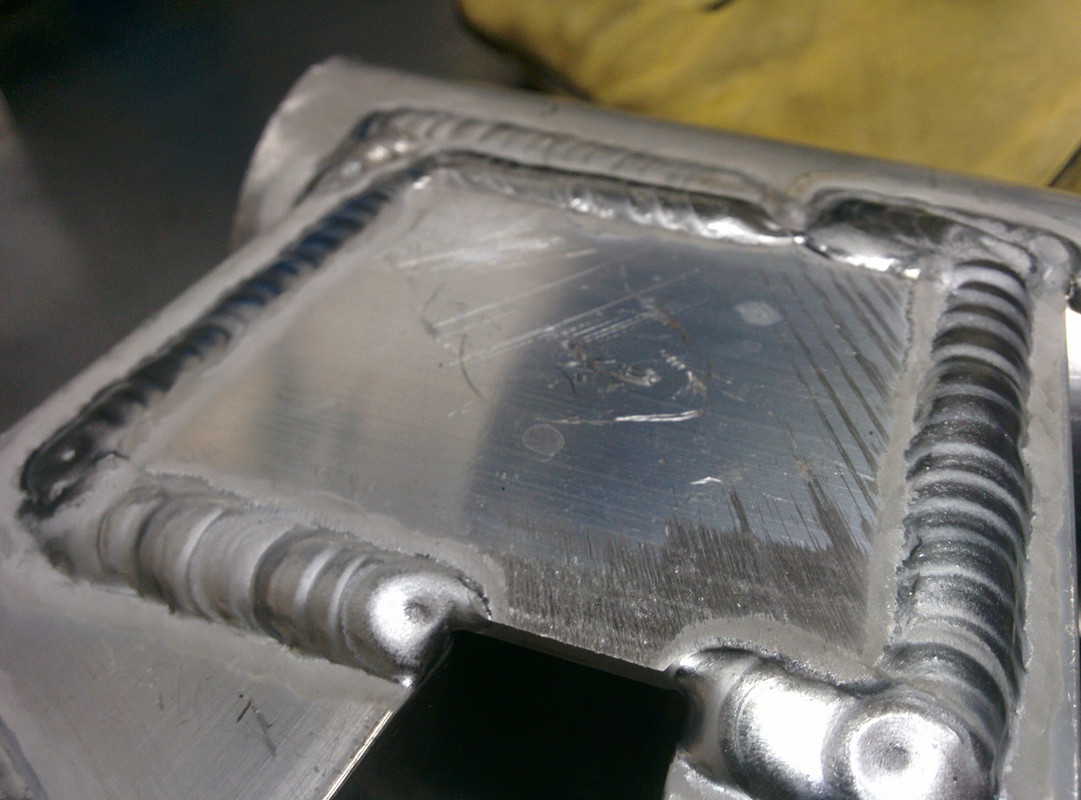

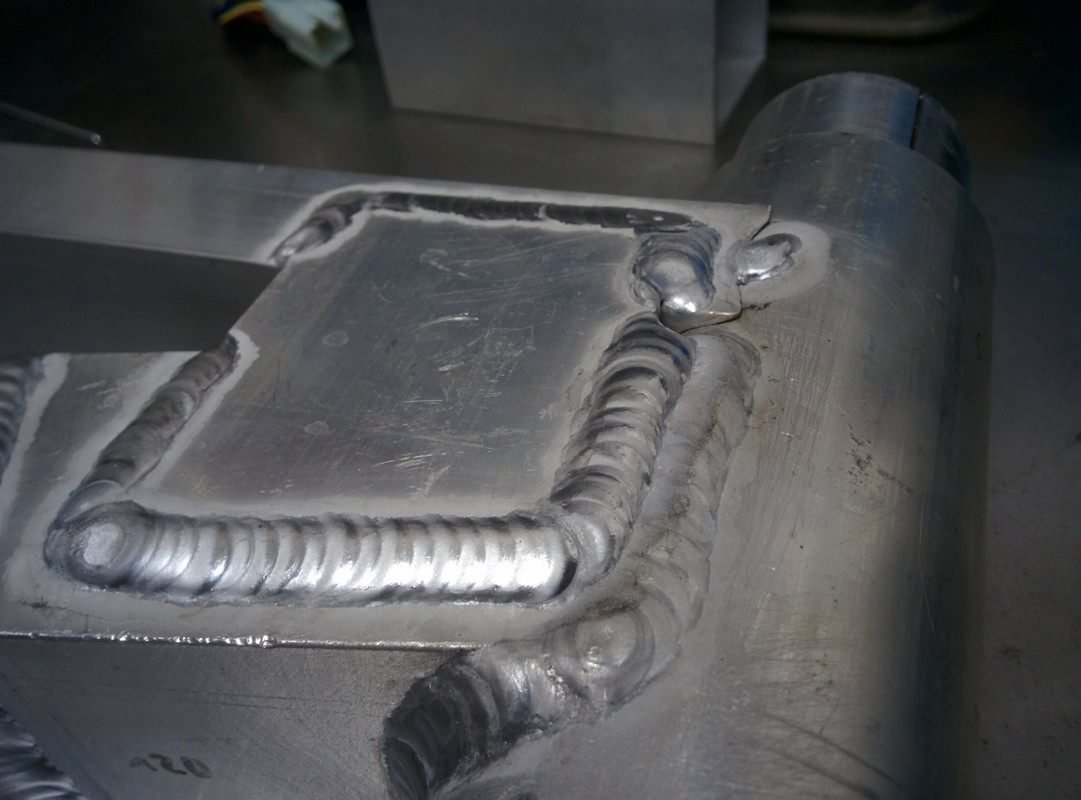

Well I'm somehow feared that this thing could break over time, because I don't really know how good my welding really is. Of course I cut some of my welds open and checked them (they where always good), and from the outside they look good aswell, but still theres this fear inside of me, because I'm doing all the development etc on my own without any experiences. Plus the alloy I'm using is 6060, not 6061 (which is common in the USA). It's pretty hard to get 6061 in germany, especially extruded profiles. Looking at the material properties, there are huge differences.. 6061 would be way better but like I said, i couldn't find any distributer..
The best alloy thats available in round tubing is 7020, which is again better than 6061 + theres no need in heat treatment, i will definetly give it a shot in future project, when I have the tools to miter-cut round tubing.
