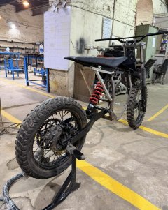

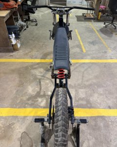

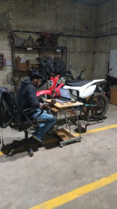

Final Powertrain testing and tuning for Proloy3 platform.. Asi bac8000 and qs138 are used to achieve around 20kw of peak power and the bike weight will be around 100kg..

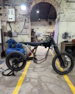

30KW 850NM Custom Electric Dirt Bike Build - Project SR Proloy 3
Build Update
Proloy 3 Specs
20s15p (72V Nominal) Molicell P50B 5.4KWH
Custom Steel Tube Chasiss
Aluminium CNC Machined Battery Box
Targert Weight 108KG
Wheelbase 1430mm
Ant BMS
ASI BAC 8000 Controller
Sotion FW04
21,18 Wheel Setup
250mm Front & Rear Suspension Travel
Top Speed 125KMPH

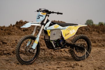

First Test on Dirt. Quite Fun and Powerful.
It did not run Full power yet, will be doing soon after sorting out some suspension and swingarm work.
Fardriver 961800 is working very good,
had major reliable problems with Fardriver 144100 , 1081000 & 3shul CC100 in my previous builds.
I found this Packaging of 26s12p very good for my kind of Riding and Racing for our Team.

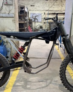

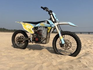

60KW - 950NM Custom Electric Dirt Bike Build - Project SR Proloy 4. Project SR
Proloy Log 2 - First Trail Run on Dirt, Works Flawlessly. Had lots of FUN.
The bike is better balanced than our previous builds and has very good power control and Agility.
We focused on a few things in this build as follows:
Stiffer Frame
Increased frame stiffness by changing the downtube.
Improved CG-
By removing the overhang of the battery pack and making it compact, the CG was also improved, and the placement of the controller closer to the Motor aided in the CG.
Improved Battery Pack -
Integrated Copper Busbar in the Battery Pack to improve Higher Current Loads and reduce waste due to heat.
Improved Accuracy -
New Fixtures made the frame more accurate and aided in better Welding techniques.
Proloy 4 Specs -
26s12p (93.6V Nominal) Molicell P45B 5KWH
Sotion GTS 35
60KW Motor Power
80NM 12,000 RPM 11.94 Gear Ratio
950NM Wheel Torque
Top Speed 150Kmph
Fardriver 961800
ANT BMS
1480mm Wheelbase
Kawasaki KX Fork & Suspension
118KG

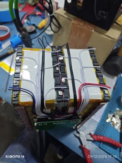

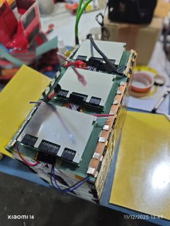

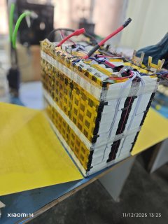

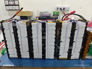

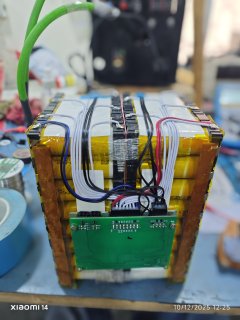

New master slave Bms integration on Proloy1 Battery pack.
this is ANT master slave bms.
This Bms has a capability to connect 9-90 series
Continuous current discharge capacity is 300A and the peak is 750A

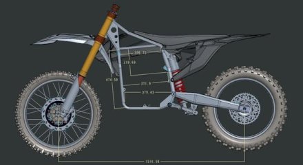

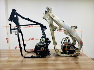

Proloy Frame vs KX Frame -
Space for Motor Controller Battery Pack Packaging Dimensions Comparison
Custom Made Electric Dirt Bike Frame VS Dirt Bike EV Retrofit
Hi, I'm interested in knowing your battery disconnect calculation. I have to admit, at first glance, your disconnect seems rather limited for 300A continuous. Then again, maybe I'm just being overly cautious.
