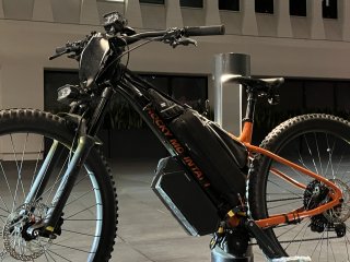

I learned the hard way why the zip ties and double sided tape that came with the a52L was not enough to hold it on the downtube after I cased a terribly steep jump. Many of you probably knew a hose clamp would be better, however that was incompatible with my frame. But this failure also proved why I chose this battery, not a dent or scratch on it
I have one of CYC's older zip up batteries, couldn't use the supplied mount - nor did I want to. I use a pair of 600mm x 50mm hook and loop straps, dead simple, easy to remove for charging (I don't keep large batteries in the house) and really holds the battery in place without stressing the frame. had a huge crash last week (wort ever) and battery didn't move at all.
That’s awesome man. I ended up using ratchet straps and put heat shrink on them, then doubled up the tape thicknessIMG_0850.jpeg
