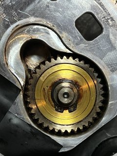

nearly 1k mile wear update, fairly heavy stress testing. Gears are perfectly fine (looks misshapen but it’s just grease), but the grease went bad likely much earlier at around 600 miles, when i started experiencing issues like higher noise levels, and sudden drive loss and scratchy noise (to be fair a little debris in the shaft and chainring area likely contributed to drag). IMG_1128.jpegI would honestly recommend checking factory grease before 500 miles. Grease looks like gruel and will be replaced with new molykote br-2 plus
PS: removing the chain guard is tough after not removing it a while, even though i removed it fairly recently to regrease. the chainring adapter is the toughest thing I’ve ever had to remove. Doesn’t really matter what tool you have because the wheel rotates all the same when trying to remove it, need really strong determination, and possibly a heat gun and mallet and vice grip

Wow, that is very different to my ~3 year old/3000km original Photon. Even the machined faces look different. I don't know if CYC continued using it later, but my motor was one of the earliest and had a very white waxy looking grease applied, which made it easy to see how bad the wear was likely to be (the grease turns grey from the metal particles caused by wear). On mine the interior of the motor was perfect and probably didn't need attention. The only reason I pulled it apart was because the large 80x100x10 output bearing immediately behind the chainring had failed quite badly due to contamination - everything else was perfectly clean.
Getting the chainring off requires leaving the motor mounted on the bike, a chain whip and the CYC pin tool (possibly with pipe extensions). I use copper anti-seize grease - just a very tiny smear because it can migrate quite easily and you don't want that - and that helps a lot.

I am curious if my issues are a sprag clutch thing, but I’ve seen one video on sprag clutch failure for the gen 1 and it looked/sounded very different. Either way, gonna take some time to fix it, cyc and my dealer aren’t exactly quick and I am busy myself

Spragg clutch failure would be a big deal on the Gen2, since CYC made a big deal about making the clutch larger to avoid failures seen on the original - as well as inherently dealing with less torque because of the change to in-runner design.

You're right it's unlikely to be the sprag clutch, I would be surprised if the steel gears wore out that quickly, but they might need perfect meshing, and it would suck if the drive gear wore out since I'm not sure it's replaceable. It really is strange because I've had days where I get it more often and then can go a few days without getting it at all like recently. I've been focused on pushing it harder than usual, but just can't get it to happen. It actually happens more often on flats than hills, usually while the motor is still accelerating. I pretty much can't ever record it when I want to, and sometimes it's hard for the camera to pick it up. I only have one video on it

I can't see the vid, but it does seem to me likely that it is the spragg clutch, especially with it being intermittent and not engaging so reliably under lighter loads. Maybe the grease is preventing full engagement. I would expect it to be more of a problem at lower temperatures and at the start of rides.

Someone theorized it could be the throttle, i will test and update. Seems possible, given the similar gen 1 issue was firmware related

The Gen 1 scratchy noise was only really evident at low or no speed, it seemed to be an acoustic effect of the controller waveform with the motor acting as a transducer. CYC have gone to a huge amount of trouble to reduce this with the Gen 2.

so found a couple more people with the same issue as mine, pretty much same phenomenon right out of the box, and we all suspect its the clutch, i mean, even cyc suspected it was the clutch and replaced it for one motor which didn't fix it, but that was for "bad grease". it sounds like more people have this issue than i thought and just weren't saying anything about it yet. if it turns out everyone has this problem then the clutch might not be designed well or hopefully its just the grease they're using. i'd also wonder how they didn't come across this problem in their own testing. some people have it worse than others, there was a point in time i had it pretty bad and now it's infrequent enough to be bearable. but if you're one of those unlucky people it's genuinely unusable and a huge oversight. however i haven't received any support or guidance on this from cyc, they just direct me to my dealer, and they seem to usually not be on the same page and very slow

The type of grease used on the clutches is very different from the rest of the motor, it is designed to be not at all sticky, so the clutch engages quickly and completely without slipping. There would be the real possibility of damage to the mating surfaces if there is incomplete engagement or slipping during use, even if not noticeable to the user.
CYC go to some trouble to spec the grease to be used in their docs for the Gen 1 so I assume they do the same for the Gen 2, and it is not a common type which is a pain for end users.

I’m ngl the more I test the more I think it’s the throttle, I edited it out of my previous reply because I could not get it to happen on a stand, but that’s probably because it draws barely any current. A mechanical issue should be more consistent and worse at higher loads
The more i test, the more i think it’s a controller bug/firmware like I originally thought
yup I think I can rule out anything mechanical now. As far as electrical goes, very likely it’s the controller. If we assume controller, now it’s just if it’s FOC desynchronization (likely), phase current over limit/protection blip, or hall sensor signal marginal near mid rpm, or throttle signal noise (unlikely).
If we assume firmware like the gen 1, it narrows it down to:
-FOC Rotor estimation bug
-Phase Current Limit / Protection Threshold bug
-Torque mapping/curve bug
also being a firmware bug is more reason they wouldnt get back to us, at least with a proper solution
