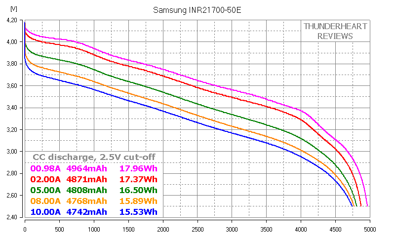

... I bought the battery for $375 and it supposedly has Panasonic 21700 cells in a 14S4P configuration. Given the miles I've put on it so far and the voltage remaining, I don't doubt the capacity but will do a full run down to confirm. I may also cut open the battery to inspect it as well and maybe upgrade the 40A BMS to one with Bluetooth so I can monitor the cells.

So far it's performing pretty well. Comes with a decent 4 amp charger that has a cooling fan. Battery and charger have not gotten warm under any conditions so far. I do plan to tear it down and take a look at the build quality and BMS after a few cycles. The only thing I did to it was remove the XT60 connector and solder on an Anti Spark XT90.

Real capacity of this battery is around 900 Wh if take into account cut-off point at 2.8V instead of 2.5V. Estimated range 100+ km assuming 8Wh/km
That panasonic should have similar discharge curve like samsung
