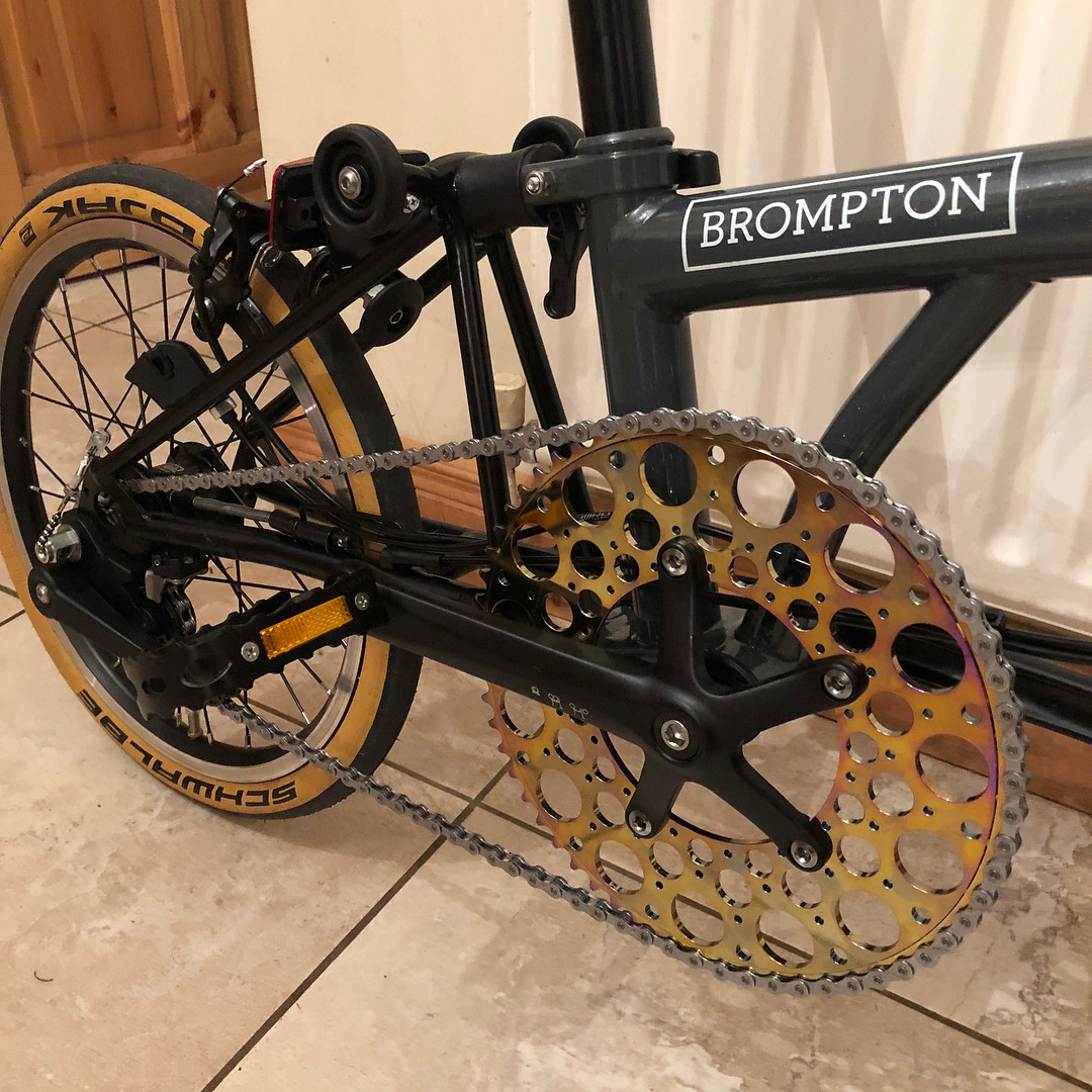

Not understanding the requirements. You can’t pedal at anything over 30mph unless you’re part hamster, so torque sensing PAS won’t provide any assist. Cadence PAS will provide assist, but you won’t be contributing anything, just moving your legs around. Most mountain bike frames won’t have clearance for a 52T+ chainring.
On my MTBs i typically accept a little crank offset so i can fit a 60T because realistically i only use the lower 3 gears once we get beyond 2kw.
That's huge!!
That's the price of entry to the always be pedaling club!
on a bike with 29" wheels you might get away with 56T
