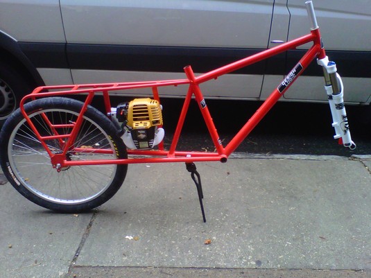

Design Logic listed their frames for sale on this site a while ago, I don't know why I didn't suggest it earlier. Seems perfect for your build.
I don't know why i didn't think of it earlier either :lol:.. I guess the reality of chain drive never caught on to me until i had all the bits and pieces in my hands. The big advantage of this frame is the lack of chainline issues.

This frame is stupidly overbuilt, 16lbs of cromo and i can't get any part of it to flex. I LIKE IT :D
But i do not have wheels or a fork for it yet :(
I am still not totally unpacked, but i had to unbox it and be in awe of the new shiny thing :)

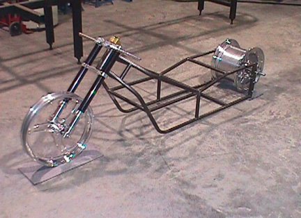

Hmm.. similarities to the actual killacycle frame..
