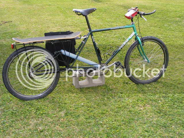

I've very very strongly considered dogman style. Even picked up 2 frames for the task. I've posted pics around here.
The challenge is to get a steel walmart dual suspension bike PLUS a steel hardtail frame of the same metal ( mild steel, no doubt ). That can be hard to do especially if you like your hardtail frames extra large like me.
Maybe a mechanical linkage could work well, i dunno. I worry about flex when the bike starts gettin' real long, ya know? your idea, veloman, is appealing, but i wonder how well it holds up.
Another problem is that those dual frame bikes can get really really long. As you see earlier in this thread, i tried to mate 2 frames up, and damn.. it was longer than 'da bomb!' screw that..
Maybe the bottom bracket on the dual suspension frame could be mounted further inward in the hardtail bike, to shorten up the entire bike a few inches?
You'd have to make a custom plate to do that, but it wouldn't be too hard.

Well i've tried to sell this frame.... i had two guys lined up to do some chromoly welding on it to shorten it down, one is not answering my phone calls, the other realized that he can't weld chromoly... so it's just been sitting in my garage looking miserable. This is holding me up from putting a suspension fork on it, raising it a little so that i can hopefully see more road hazards in advance, and so forth.

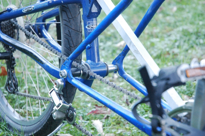

In the meantime, i have revisited the franken bike idea yet again.
When the vbrake posts are removed, i know that there are decently sized bolt holes which can help form a structural link, conveniently all it would take is a bar with a 90 degree angle, plus a fat axle to make that linkage happen up top.
I have the cranks pointing towards the dropouts, as if they were to actually be bolted into the dropouts, but one thing i could do is point them downwards, cut about 80% of them off, and hook up to the lower chainstay, bolting it in maybe, or maybe using a pair of something that would clamp / bolt to them 2x on both sides.
No suspension this way, so that sucks. But i'm really not sure how a midtail could be done otherwise.
Maybe a shorter rear swingarm designed for a 24" wheel could be helpful here?

The welder dude got back in touch with me and is now in possession of my bike.
:mrgreen: :mrgreen: :mrgreen:
Might have the bombproof midtail of my dreams soon..
Honey, i shrunk the bike!!
Am i totally happy with it.. hmm, i think so! The crap part here is that the dude who welded it didn't cap off the tubes, so i have a tube at the top and the bottom that are open.. this is not good for the strength of the bike. My welder guy is not a structural engineer tho.. :mrgreen:
So i am going to get the ends capped off and the build will restart :]
Oh and the wheelbase is now 52 inches. This matches the genesis 32" bike. I rode the Genesis 32" bike and like it a lot. The way it handles is right in between the buslike feel of the 'da bomb' or a Yuba Mundo at full length, and the twitchyness of a mountain bike. I have a feeling this bike will handle the same.
