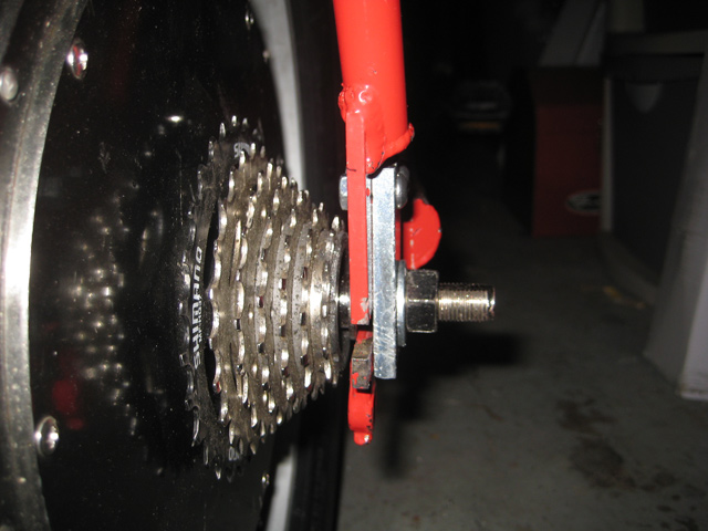

Made some big torque plates for this frame, as the HS3548 had managed to literally spread that thick cromo and start to round out the axle a little bit too.
Double the steel holdin' the axle oughta do.... i hope... lol.

Took me about 2-3 hours to make the torque plates and get the hub motor running. Shoulda just bought a cromotor at this point.
