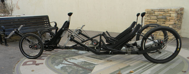

Nice ........ but a Quad ... not legal in my area as a bicycle(tricycle)
i have talked to Ashley at Utah Trikes
I could just lengthen my rover to a tandem but the social still is attractive to me.
http://endless-sphere.com/forums/viewtopic.php?f=3&t=34445
[youtube]0bykT_PKqig[/youtube]
http://www.utahtrikes.com/TRIKE-2011TTROVTAN.html
