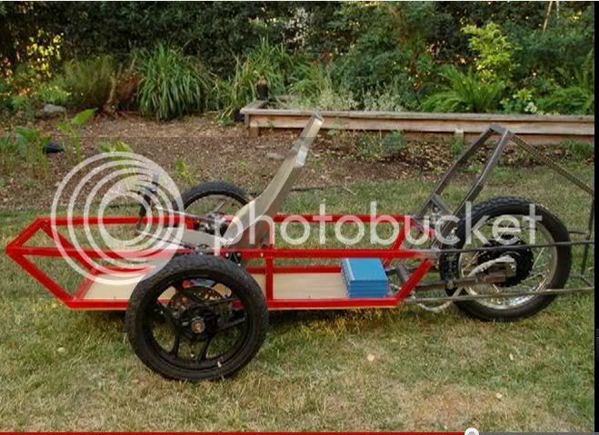

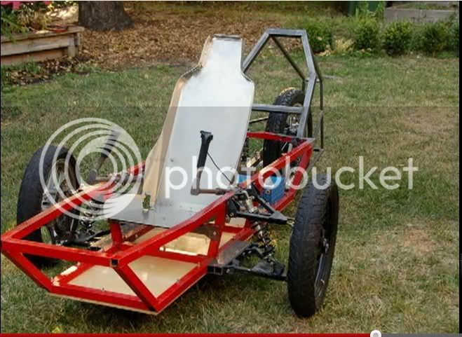

I finally found a frame builder in N. California
patrickza said:
Quite a simple looking frame. I wonder where he got the steering components. I think HAL could do this really easily, come on HAL here's your next kit to sell!
Stills taken from the video:
With just a few changes, this is exactly what I was thinking about. It wouldn't be hard to move the front wheels forward a bit so you could narrow it track bit and add pedals to keep it legal as a bike.
Maybe you did, but I didn't. I would rather have a fake ass set of pedals on it and call it a day than have to deal with licensing issues that vary from state to state, let alone from country to country. If you want something that ACTUALLY can be built and used without a lot of hassle, an advanced form of a velomobile is the way to go.
And again, who said the pedals have to assist jack? They are just there to keep it legal. We all know that at 50 mph your pedaling isn't doing a damn thing. But when the cops stop you, you have pedals. :mrgreen: Kinda like the same reason we still have pedals on most of our bikes.
