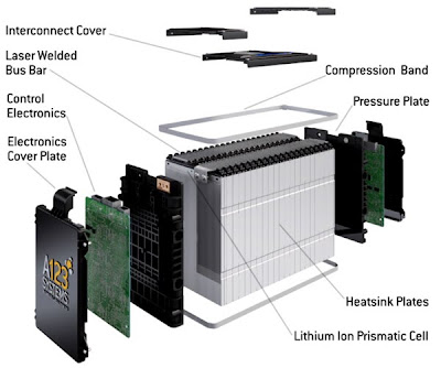

I'm very interested in these cells at a great price. I still would like to see different ways of connecting this cells. I see the bar clamp method, can they be solder. And what kind of solder ? Gestalt I bet your finger prints are all over the glass. Did they have to ask you to leave so they could lock the door ? It's after 5pm.
Connecting cells...my idea....Use nylon bar ripped to about 1/4 thick( not exact for these cells, but .240 thousands was corredt size for the FFR 25a cells) . The length is the width of the top of the cell. Set these in a jig, drill three holes , left middle right side of tabs . 1/4 or 5/16 through so a threaded rod goes through all pieces, nuts on the end and your done.
Balance wires of course between the tabs ( i'm thinking small wires like on the lipo packs) No need for soldering. Easy to take apart etc . I have this nylon bar in 3/4 and 1 inch thick. Think it's called hi-density polyproplene, comes in different size sheets from McmasterCarr.
Tell me whats wrong with this idea. Cass

Since I am planning on a 6s2p pack for a 48v 40ah pack I'm thinking that I will use two copper bars with bolts to make a tab sandwich to parallel two of the cells together. Then run the series connections from the copper bars. Should make it pretty simple to take cells out if they ever need to be replaced or worked on. Some simple rubber or plastic caps to cover the connections and there you go.
I like the idea of encasing them in resin, it would insulate the cells but would make it impossible to do repairs. You would have to just scrap em. Plus, dont these cells like to have a bit of compression?
Supposedly we should not need compression but the cells need to be protected somehow. I like the copper sandwich idea but there would have to be some good insulation, perhaps Coroplast to protect adjacent electrodes. I would probably use lexan or regular acrilic to protect the sides from puncture. Maybe even Choroplast. Anybody got a drawing of the connectors that they want to use?
otherDoc
So how about borrowing a bit from ol witty jack and cast just the copper parts in the resin. Drill out the holes for the bolts to go through. I think you would need to use hex key bolts so that you could use those "L" shaped ones to get in that tight space between cells when tightening. Probably would even need to shorten the key a bit.

I'm thinking something like this. You take the two cells, bolt them together with the copper bars. Then solder on your series connection wires and on two ends of the pack the battery leads. A short piece of a straw or tubing big enough to go around the hex bolt. You put a mold over all that, I was thinking of making the mold from an ice cube tray. The straw would keep the resin from covering the hex bolt and giving you a path to loosen it. It would look something like the recessed screw holes you often see on portable stereos.
If you ever needed to swap out cells you would just have to loosen the bolts and slide the cell out. Might look cool too.

So I am going to be in on the group buy if I can pull my funds together in time. My plan is to make modular trays out of 3/8 ABS plastic similar to what eig and a123 does with their cells. Inside of these units the cell are flipped to create the series connection and balancing leads could pass through out to the ends of the cell blocks. I think I will machine pieces of aluminum that will sit against the tab and carry current from cell to cell and will be crushed together when the whole thing is screwed together. I wanted to completely in-case my cells with these modular parts so that it serves as a hard case too. The whole thing will bolt together with all thread or similar. Hey maybe at some point if I get the design down right I can move to have them injection molded instead of cnc'd.
Oh and I wasn't going to worry about heat. I was considering putting a .5mm air gap between cells in which air could flow but that would also open it to the elements.
Don't overlook the requirement for compression bands (as noted in EIG's proof image). The majority of the tinkers buying these cells do not realize that until it's too late.

Seriously guys, don't worry about heat; just make sure your terminations can sink it. This is the biggest single factor in battery longevity and performance in my opinion.
Think about it - the tab is the bit that gets hot. Whatever is attached to this tab will sink it. If you have a nice big lump of copper block there to sink it and take the current, great. If you don't, the cell itself will sink the heat - not good. Air gaps are unnecessary and only introduce an opportunity for dust, water, crap and vibrations. Just don't skimp on the terminations and you'll be fine :D
