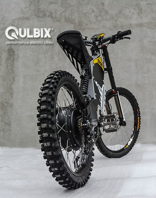

Been a while mate, hows it all running still?
I broke my frame again which kind of spelt the end in my head for any more $$$$$$$ spent on the mid drive.
and have started heading back down the old hub motor trail. It's looking like a big heavy expensive one.
Damn John, so, how big are we talking motor wise? QS273?
Hey Rix,
to me even 205 is big, I am just gona have to suck up and get used to the weight again. I dont see the point any bigger than that. Ive ridden with mates dumping more than 15kw through theirs.... I am even scared of half that power....
My bike should end up looking pretty generic, some would call it boring.... me would call it
:twisted:
