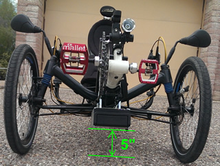

Alan B said:
Welcome to ES. Looking forward to your pics.
Ebikes handle so much better when the weight distribution is right.
That's especially true on trikes as well.
I usually deal with battery placement with modular solutions. I first fit a 4 bricks pack on the front of the DH fork, sometimes 8 small bricks, total weight making less than 10 lbs. That, combined with slacker steering angle mod, is the best balance/handling I can achieve. In hard acceleration especially, some weight and geometry mod on the front are making the bike more stable. The controller goes under the top tube. Triangle mounted batteries are best when you need a lot, when their weight does exceed the weight of the rear motor at least. The idea is to try making the bike weight balancing on the front of the BB.
When I need extra batteries for range, they are going in a frame bag or carried as luggage. Since my rides are mostly sport and short, I prefer to avoid a permanent setup of heavy battery.
