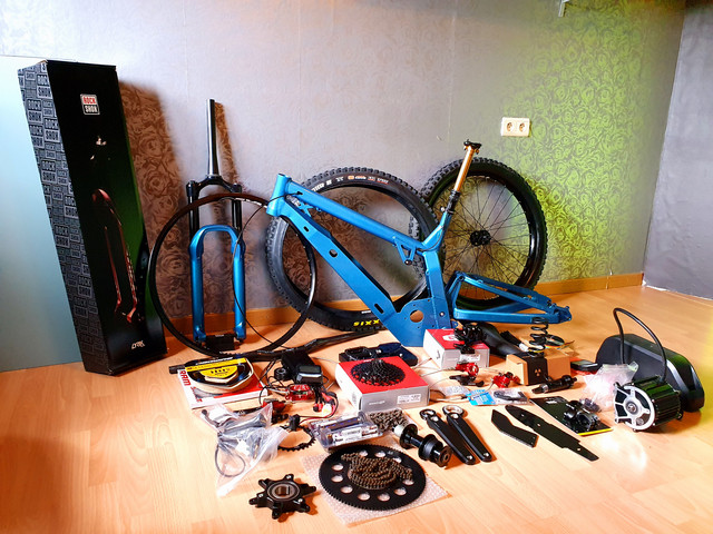

Hello people ,
i am new here and i will introduce my project lmx64
in the past i was a nyx bike owner, i decided to sell it.
some time ago I came into contact with adam where i decided to buy lmx64 frame.
after a long time i can start build my lmx64.
i want to thank adam for taking the time for me.
and the good service.
later I will explain more about the set up.
croydon said:
Hello people ,
