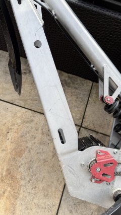

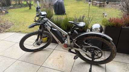

I actually did it. I cut my frame. (Not a lot)
1040watts 20Ah 21700 HL hailong battery.
Fits perfectly. Now I pulling 3200watts peak.
It’s increased my range on full power.
Increased the max power settings to 60amps. No problem.

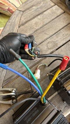

What did you have to do aside from upgrade the battery and cut the frame? Looks like a great result. How’s the extra range?

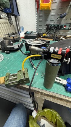

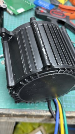

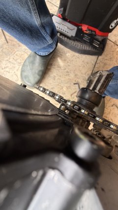

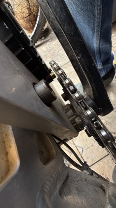

Hi Blake2020.
Haven’t been here for a long time. After installing the battery. I loaded my highest configuration and did a full auto tune, that’s it. Arh you have to tell the controller the battery size. I just installed the 50mm motor. Today. It says it has 10 poles. I set it up with 5 by mistake but it still runs. Just charging the battery and will do a new full auto with 10 poles. The 50mm motor fits in without any problem. I have to tap the screw holes and spin the holding bracket to the correct place. I cut of the connectors from my old 30mm motor and soldered them onto the new wires. Apart from that. Very easy job.

Nice upgrade! And I thought 40mm was the max size motor!
Going from the 30 to 50mm motor you must notice an improvement in torque and it should barely ever get hot.
My 40mm motor improved the heat soak on climbs quite a bit, but doesn't make much more torque for the same power over the 30mm.
How much did the 50mm motor set you back?
Cheers
120$ plus shipping. 100$. So 220$. I haven’t try it out yet. Only took it for a quick spin. I was on the IPM40 before. Just couldn’t resist going for the 50. I thought it would fit. And Yes it does. ChatGPT is now working out the best setup for the 3 modes. Normal, race, and boost. It also figured it out that the Nucular is 5 pairs so that’s 10 poles. So I have the right auto tune. The bigger battery lets me go about 10km more. I was normally at 32 in full power mode. But switching in between to a lower mode give loads more. I’ve riden on low mode over 100km. But the high mode eats into the battery. But 42km is not bad. I think my next move is an even bigger battery and more frame cutting. But that’s in a couple of years. The LMX64 is very versatile.
