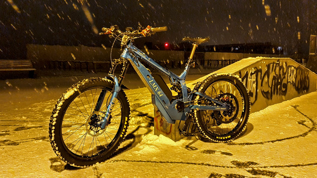

Hi Guys. Lmx64 testing in snowy and cold conditions.B0B3426F-2A9D-4821-86B6-0B68E71C81E3.jpeg. New tension pulley and stronger belt seems to last longer than first belt and small tension pulley( 40km and broke). I think tension pulley is huge improvement for belt lasting. In snowy conditions,
if snow goes between tension pulley it create problems quickly. Ice is pushing belt to the side and also tensioner woppling alot up and down. So belt not so good for extreme offroad, like Adam advice me in the beginning.
This powder snow conditions and good path/trail not creating problems at moment.
Still i have freewheel slip problem when temp -10C. Also my friend has same problem. Brand new skf oneway bearing little helps reduce slip problem comparing used bearing in muddy condition. But the fact is that temp is below limit what skf gives for operating temp, and if using bike when cold new bearing also slips. Adam promised to fix this issue and he is working with it, but he seems to be busy and propably focusing more urgent things. Support from Adam been always super good.
About belts, i ordered 3pcs polychain belts, those are strongest belts what we been using in industry. Lets see how those will last, once get them into testing. They cut these belts from 36mm belt so witdht is 12mm. Btw, did you have variation in width of belt when you received these HP ones? Mine was variating in one belt 10-12mm and one from 9-11mm, which came from Lmx.
Anyway bike is now working and super silent comparing chain. I try to use this belt always when its possible. But sometimes it must be change to chain, if conditions are difficult. I have two rear wheel so its not so big thing to change from belt to chain.
