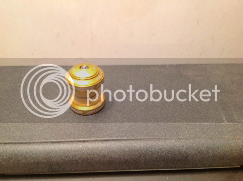

Purchased FSA headset today also a set of avid code R brakes.
Ryanthelion, beutiful components! The avids and the gold ano headset = beutiful looking build. :D
