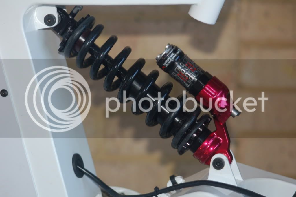

Well... I finally received some shipments from chainreactioncycles.com and HK... and can start the assembling of my bike.
Here is the list of what I'm going to use:
Front
- Chosen Hub DA-4311B-M20 with 36 2.00mm spokes in Supra34 AlexRims, CrazyBob Tires 26'' 2.35'', Maxxis Freeride tube, 185mm DirtyDog rotor.
- Marzocchi 888 RCV (2012's build) 8''
- Hope Stealth M4 EVO brakes
- Chris King NoThreadset 1 1/8" Headset
Rear
- MAC 1000W 8T in DX32 Alexrim, 36 2.3mm spokes, Maxxis Hookworm 26'' 2.5'', Maxxis DownHill tube, 185mm DirtyDog rotor
- 7speed 13-28T Shimano freewheel
- Fox shocks dhx rc4 9.5"x3.0"
Electro
- 16s LiFePO4 BMS, 12 fet IRFB30 Infineon Controller
- LiFePO4 53.2V 25.2Ah Battery
- V3.0 CycleAnalyst
As for the moment, I got a little problem:
The seatpost. It can be easely twisted round it's axis
(the seatcamp is curled almost up to a limit)
Do you know how this can be fixed?
