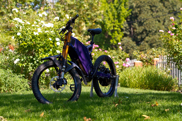

FRAME / OTHER:
The frame was fortified and weleded where it cracked.
The Rivnuts were all welded to the frame so they can not move now.
The side panels were welded and cleaned up so they don’t separate.
All of the wires going though the frame are held in place via Velcro.
The frame was painted and all flat carbon stickers were replaced w high quality VVIVID high gloss carbon stickers.
The stock strips of foam that are along the edge of the battery box were replaced with bespoke custom cut neoprene.
All exterior bolts have a nylon washer on them so as to not damage the finish.
The swing arm as custom cut neoprene pieces on the top and the bottom on the chain side so you cannot hear the chain at all anymore! The chain slap used to drive me nuts!!
The side cover bolts all have a dab of silicone on them so they don’t back out.
The side panels have single piece gaskets where they touch the frame so as to not F-up the paint on the frame.
The controller has neoprene on it where it touches the frame and also has 4 spacers stabilizing the controller.
