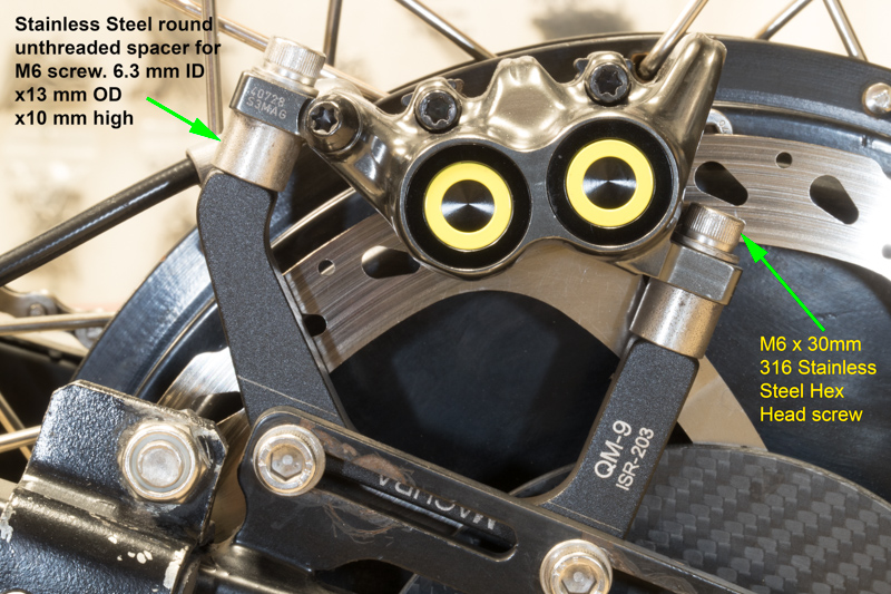

One fairly easy way to increase your Bomber stopping power-and this will make a very noticeable difference-is to change out the disk brake rotor on the rear wheel from 8" dia to 9" dia (front is OK as is with 8" dia).
To do this you need to find a 9" dia (224 mm dia) rotor. Hayes makes one but they are not readily available. I bought two of these as spares from eBay and I see, as of today, they are still available on eBay from the same vendor I bought from in 2016.
Here's the eBay link. You get two 9" rotors in the purchase which makes this a really good deal.
http://www.ebay.com/itm/2x-Hayes-9-224mm-disc-brake-rotors-Motoped-/272188440321?hash=item3f5fb1ff01
Install would look like this. The one shown is a 9" dia Hayes but mine came from QMS and has a carbon anti rattle suppressor. You can live without this and the 9" should work fine.
Beside the two pictures shown, there are larger pictures of my 9" Bomber disk brake rotor, which can be found in my collection here:
http://www.fareinc.com/Bomber-sale/index.html
Jim
Thanks for the info, Jim: with the bigger rotors, what sort of caliber adaptors do you need (if any)?
Here is a link to McMaster Carr my source for hardware. You can get stainless steel machine screws and spacers there.
https://www.mcmaster.com/#unthreaded-spacers/=15z9kyw
For finer height adjustment (added atop the spacer) you look to use stainless steel round shims (vs round spacers). ID=6mm x OD=12mm x Thickness (try 0.5 mm and 1.0 mm to have on hand). I use 316 stainless steel round shims and I have the 4 avaialble sizes McMaster sells.
https://www.mcmaster.com/#standard-shims/=15z9y1u
The idea with the spacer + shim + sliding the entire caliper backwards and forwards in the swingarm bracket, is to get the rotor to spin in the caliper opening as close to the top as possible in the center of the caliper opening without hitting caliper metal. This will maximize the pad surface in contact with the rotor. Once the caliper is in the correct position tightening the M6 screws will keep it there.
For future adjustments (i.e. pad changes) I remove the pads, push the pistons back into the caliper using McMaster tapered wooden shims(one on each side of the rotor and push down), loosen the caliper screws and then use my eyes to center the rotor in the caliper opening. Tighten the caliper screws and then insert pads. This procedure gets the rotor centered in the caliper so the pistons each move out equally during use.
https://www.mcmaster.com/#wood-shims/=15za6mx
Jim

Whats the carbon disc for?
I purchased my original 9" Hayes from QMS (no longer in existence).
"Install would look like this. The one shown is a 9" dia Hayes but mine came from QMS and has a carbon anti rattle suppressor. You can live without this and the 9" should work fine."
Jim
