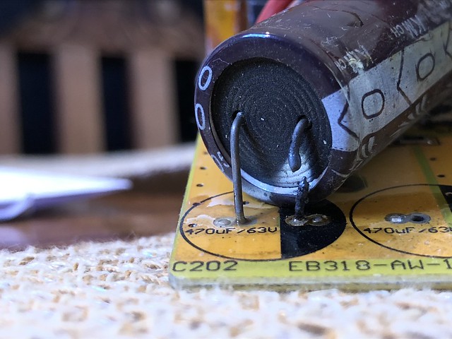

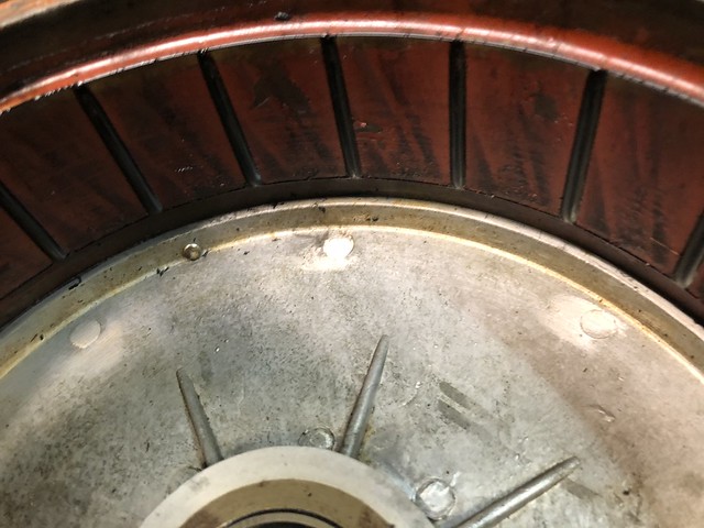

Soooo my bike started to act odd recently..
upon heavy load it studders and has a lack of power. I tested the halls and phases all good. My temp sensor wire at the plug needed a little love so fixed that. Noticed that the regen button wires also broke at the solder... oh goodie..
Checked the controllers Mosfets.. all good. Ugh plugged everything back together.. no bueno.. decided to pull the motor apart but everything looked good... Hell even the Statoraide was still in there from when I put it in over 3 years ago...
So decided to pull the controller... Sounded like a damn rain stick..
one blown Cap. 2 caps loose, 3 more caps have at least one leg burnt... I think this has been going on for a while. I ran a temp strip on the exterior of the controller for a while now but didn't notice any overheating.... and now for some pics!!!
So about that new controller.... may need to get one a little sooner than expected...
