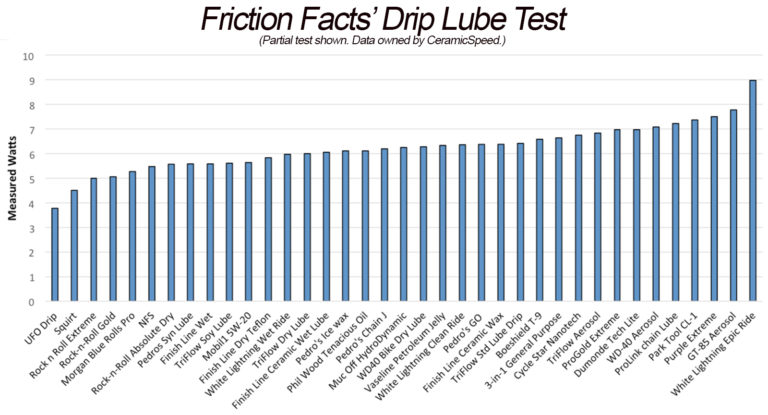

Added friction watts per drip lubricant:
https://www.cyclingabout.com/wp-con...cts-Drip-Lube-Test-e1577043238352-768x415.jpg

Looking at the tests again..
.. wax, and even drip wax seems to do great in dirty conditions.
..and a mid drive rider is more likely to be riding in this condition, so maybe a high end lube wasn't the best recommendation.

Drip wax seems to be a nice middle ground.
I didn't research drip wax much. Is it really the convenience of lube, but with wax? What's the tradeoff?
