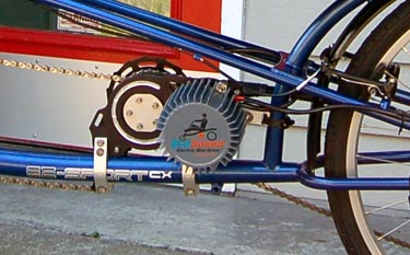

would appreciate all feedbackabout ecospeed mid drive system.am thinking seriously about buying catrike trail and have it equipped with ecospeed .what are the performance stats at 48volts.thinking of buying from utahtrikes.com? any thoughts welcome
Their BB "mountain-drive" (similar to Cyclone/Elation) has adaptation brackets to use the 600w BMC V2-S, and also the V2-T. They also have a 1,000w motor option that carries their label that I can't identify. You have the option to buy the kit without the motor or batteries for $920-$1,020 (for single chain ring or triple)
Their mid-drive kit (like a Stoke-Monkey) has the same motor options, or can be purchased with no motor or battery for $945

A question though - is the ecodrive the system which has a, how do I say this ... a saw blade for a sprocket? I saw this somewhere it looked interesting, I assume the tapered teeth of this design are designed to eliminate driving the motor when pedaling without a freewheel at the motor but I assume a crank mounted freewheel is still required or the pedals would always turn with the motor still.

Yes, I have a Catrike 700 that I am installing a drive unit on. I already have a disc ready rear wheel installed for use with the left side chain (on the disc brake flange). I also designed rear frame braces to reduce the rear triangle flex associated with Catrike frames. I have drive units that pretty much bolt right on (clamp around the frame) rather than require drilling of the frame as the Ecospeed does (the Ecospeed requires drilling holes in the frame and using water bottle bosses to mount the drive).

Ordered two of these mid-drives. They utilize a patented "freewheeling" crankset that slips(internally) and after sending it back it is is wiggly and slips worse. To better define slipping; The freewheeling crankset allows the rider to run the electric motor without pedaling. There is an internal clicking just like on some rear wheel free wheels. Only these pieces of crap spin both way's not good.
