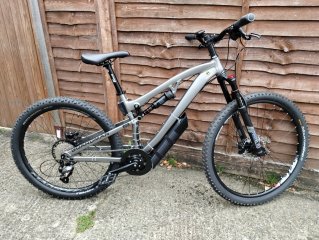

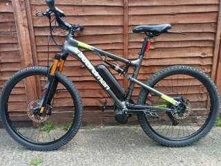

I ride a lightweight mullet e-bike which has a TSDZ2 mid drive with a 36V 10ah battery which weights around 18kgs plus me at 63.5kgs, I cover 20 miles on a full charge or 30 miles if I watch it. I ride mostly on the flat with a couple of hill climbs, I do have a grey 29er with a 48V mid-drive with a similar battery and again is around 18kgs. I have had no problems with the Tongsheng mid-drives covering over 2500 mile on the one I ride most of the time.
