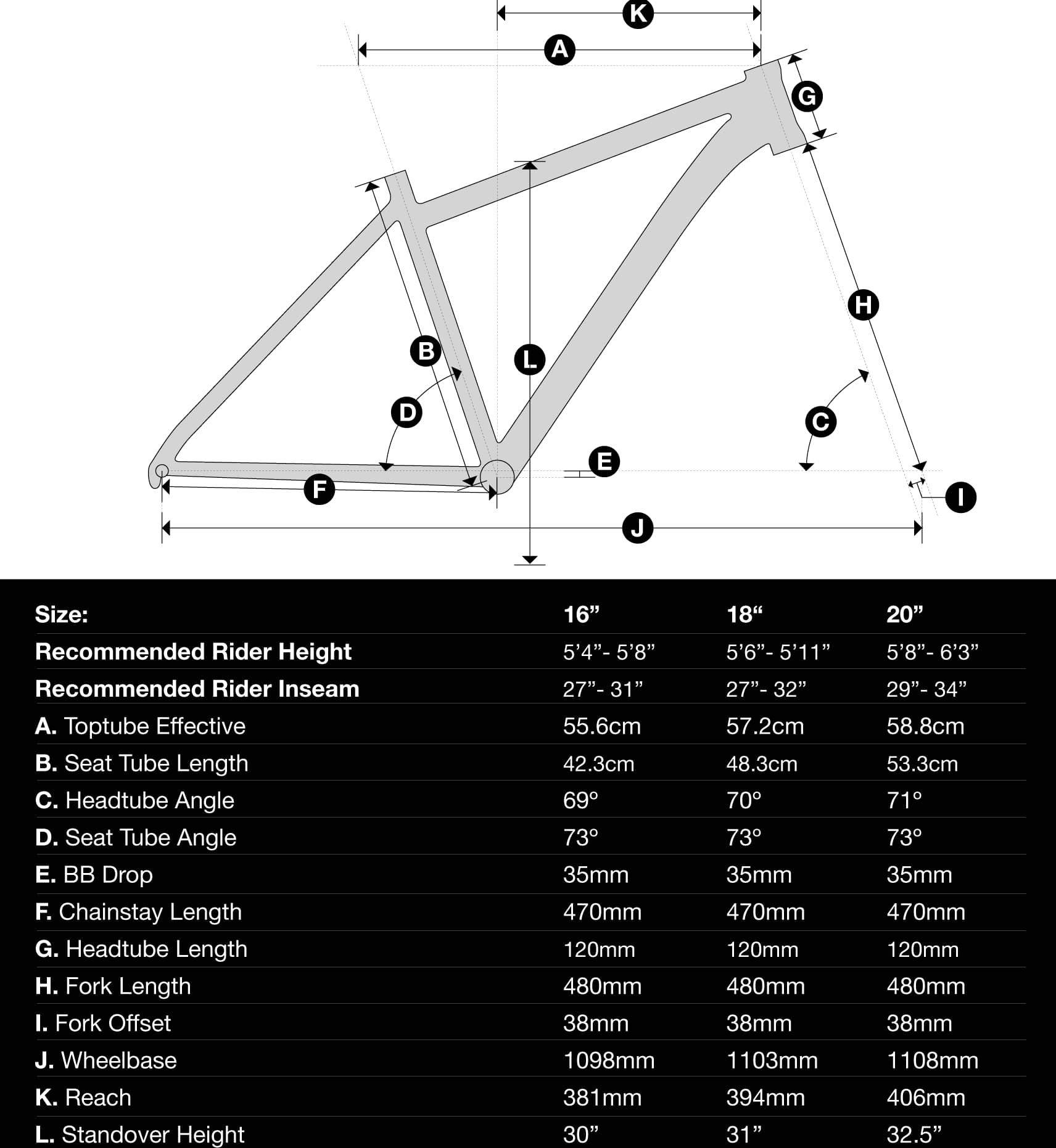

Hi all, I've done some cursory reading on bike suspension geometry, but I still need to learn some more about what it means to convert a bike from rigid to hardtail. I know that some of the factors at play include Axle to Crown Length (A2C), Sag, and Head Angle.
My latest Ebike project is a 2020 Framed Minnesota 2.0, size M (18"). Here's the bike's geometry.
The fork length is 480mm, and the offset is 38mm. By my math, this makes the A2C ~481.5mm. The bike's front fork is rigid. I'm strongly considering DOT tires for this build, which I imagine will act as less of a shock absorber compared to standard fat bike tires. Ergo, I'd like to replace my rigid fork with a suspension fork.
This is the guide I found about fat bike suspension forks, which is where I'm getting a lot of my information about suspension theory.

Now, to the main point of this post: how would changing out this fork affect my suspension geometry?
To figure out how long the fork will be when assembled on the bike, I need to figure out how much sag is going to be introduced. I have limited data for either fork's sag, and I'm trying to extrapolate from what I have. If the sag is linear, then at 20% sag, the Mastodon has an A2C of 504mm and the Wren has an A2C of 508mm.
The above article says that the majority of fat bike frames aren't designed for a sag A2C of above 511mm. I have no independent verification for this claim generally or for my specific bike; I'd love more context or info if anyone has it. I have no conceptual knowledge about sag in relation to bike & rider weight, center of gravity, suspension travel, etc. What does more get me, what does less get me?
Head angle is also a concern of mine, since it factors into rider position along with fork length. Sheldon Brown says the head angle change (in degrees) is represented by the formula: arcsin((old length(mm)-new length(mm))/1000). The stock head angle is 70deg. This means that the head angle using the FL measurement is 67.6deg for the Mastodon and 66.8deg for the Wren. Using a measurement at 20% linear sag (an educated guess from other models, but probably within a few mm), the Mastodon is 68.5deg and the Wren is 68.2deg. According to Sheldon Brown, if the sag measurements are correct, then the change in head angle is on the high end of acceptable. Is this correct, or should I be doing something different in my research or math?
According to this image, getting a longer fork that decreases my head angle would put my seating position further back and higher up. How would that change in weight distribution and center of gravity affect my handling either when accelerating or decelerating or when cornering?

  • 2020 Framed Minnesota 2.0 Geometry.pdf

Also, I can't access your linked "geometry" file. If you attach it to your post then anyone reading hte post can access it.
Sorry abt that, just re-attached it.
