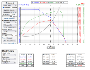

Rough analog in the Ebikes.ca simulator:
Design goals: 100lbs total. Top speed of over 60mph ideal, but 50mph acceptable. Greater than 25 mile range, preferably more. Under $2500 total if possible.

Rough analog in Ebikes.ca sim:
Design goals: Light enough to fit on the bus. Top speed of over 50mph ideal, but 45mph acceptable. Greater than 25 mile range, preferably more. Under $2500 total if possible.

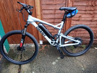

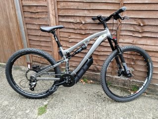

Hi Gus, I have a few DIY e bikes in full suspension MTB frames with a 26" front wheel and a 20" rear hub motor, also bmx bars to further lift the front. I like the feeling, and recommend the style, and the smaller rim seems to outpace my 26" e bike when I ride with guests.
I always now seem to prefer full suspension mullet e-bikes at the moment either a 27.5" front and a 26" rear or a 29" front and a 27.5" rear combo, I ride the 27.5" front and a 26" rear thro' tight forest run and the 29" front and a 27.5" rear on fast tracks etc.
Yep, my 26" rear hub ebike has a 29" front wheel with bmx bars, it's a full suspension Motobecane
Although I have a Giant Trance with a a 27.5" front and a 26" rear setup with a Bafang 500w rear hub, I now tend to ride my pair of 27.5" front and a 26" rear and 29" front and a 27.5" rear combos which have the TSDZ2(B) mid-drives as they seem to be better balanced and lighter plus due to the torque sensing I get more range. These two do have small batteries as I lightweights with about 30 mile range, I do have another with a 48v 15ah battery for longer rides but I also have a range extender kit.
