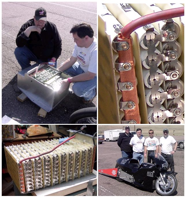

NEDRA electric drag racers use unusually high voltages, but of course they build their own custom controllers and are not concerned with range. "Killacycle" used 375V
http://www.nedra.com/record_holders.html

does killacycle use BMS?
At ebay they are around 70$.. dont buy them at evparts or similar.. they are too expensive!!! :shock:
Yes the killacycle have a BMS.. it's a shunt type BMS similar desing than Ggoodrum but it's a transistor that shunt the overvolt.. not a resistor.
I have some of their first BMS batch version .. they only shunt 70mA... but their new version is alot better.
