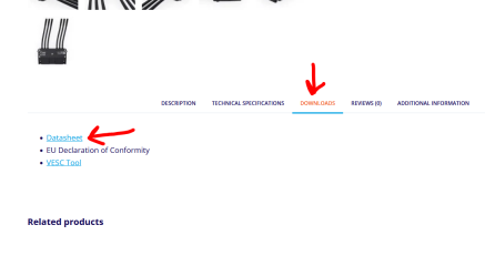

Where I can download the schematics for those things? If I go the the DOWNLOAD section it has DATASHEET file but there is no schematic in that file
