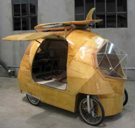

I am also planning on using solar power to assist with charging my trike. I would like to have a large camping trailer that I can equip with solar panels, but I think I will probably start with a solar canopy first.

If I were doing this again, I think I would start with a Surley or bikes at work, long trailer. In fact, that is my plan for V.2.
I want to make it openable so that I have ready sleeping space. Also, by openeing it, I can collect more morning sun as I am getting ready to head out.
To use an existing bicycle and build a nice and simple plywood trailer, covered with solar panels and enough room to sleep in, seems like a very interesting and affordable project.
Oriol
