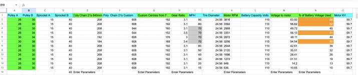

Hi, I've been seeing what I can use for the jackshaft set up, and seems like I should be able to go with Gates 8m 21mm Carbon belt and pulleys, think I've figured a way to mount the pulleys, rfndzc advised that I can just use one of the QS180 splines with a key Belt drive conversion on honda CB350F, but I've been enjoying Fusion360 so just put in an order with sendcutsend to see if this'll work in between the motor shaft and pulley taper bushing.
Also been playing with gear ratios, planning to design the motor/jackshaft mount so I can tension the belt by moving the motor, and also allowing enough movement to accommodate a few combinations of pulleys if I need to change the ratios.
Here's what I have so far, if I go with a 110v battery it should do 70mph at around 50% of the battery, at which point the effects of bemf will start to be noticed, if I've understood this correctly, maybe? thanks Amberwolf for the responses. I loath using spreadsheets but chatgpt helped me get together some formulas so I can easily see what different combinations should yield.
