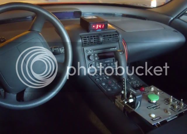

Next job is getting all the wiring moved to the interior and drilling holes & putting grommets in. Running the 4/0 through into the trunk will be a real chore.

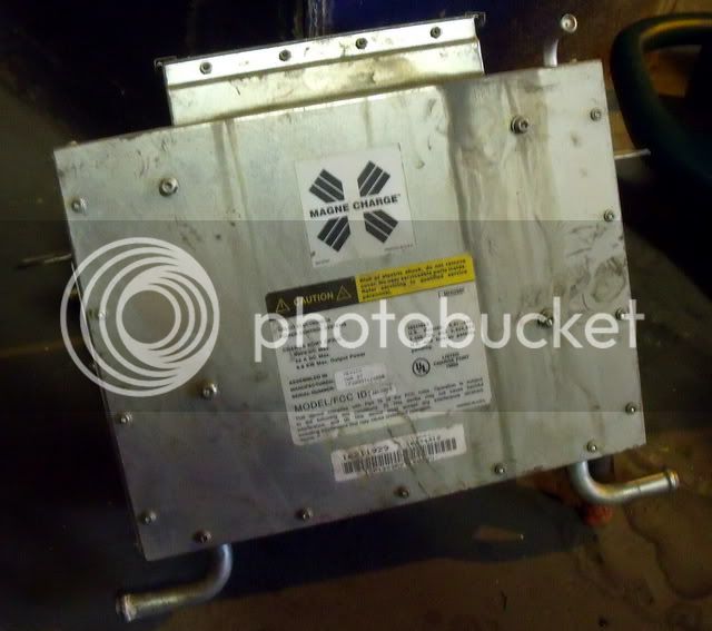

In addition, it's time to see if the DC/DC converter still works, then to make a plan on how to get that battery tray raised back up and inside (might be able to borrow the school's lift). Also...

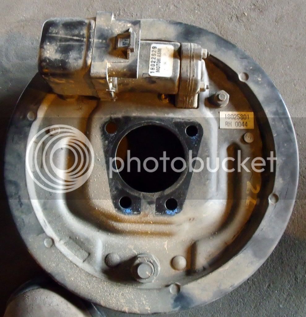

:?: ADVICE NEEDED! The rear drum brakes are operated by small brushed DC motors (each is 12 V, and about 150 W maximum) that push out the drums. Need a small PWM controller with a potentiometer (or similar) input for them. The idea is to adjust torque to have the drums close with varying force. Any suggestions? Thanks in advance.

That sounds like a weird braking system.
If you disconnect power from the brake motor, do the brakes release by themselves or do you need to power it in reverse?
When the brakes are applied and holding steady, does the motor just sit there stalled with full current?
Assuming the braking force is roughly proprotional to the brake motor current, then you would want some kind of current mode controller that increases the motor current as the brake pedal is pushed. You would need some way to adjust or calibrate this I'd think too, so that the brakes don't come on too much or too little.
Does the brake pedal have some kind of pot or encoder?
Hi fetcher,

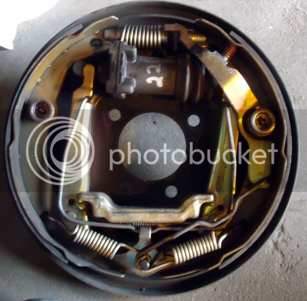

You're right, it's weird. I had to take the assembly apart to see how it worked, but essentially you have a small motor mounted behind the drum backing plate that, through some gears, spins a threaded bolt (with an end cap fitted with a retaining ring) that extends a rod against the inside of one of the brake pad levers. It pushes with more force the more voltage that you give it, and it reverses direction if you switch the polarity.
Rear (motor) side of backing plate:
Front (telescoping rod) side of backing plate:
So, if you limit the voltage to limit the motor's torque, it can't open the drum all the way, and so the pad slows the wheel down more slowly. I found that by applying a different voltage (between about 2 to 12 volts), and allowing the motor to draw as much current as it wanted to, the braking force could be adjusted. My first test was screwed up because I was inadvertently limiting the current along with the voltage.
The brake reverts to the closed position when power is removed from the motor, and I believe this is because the threading on the bolt is angled sufficiently steeply so that the springs can push back against it (now unopposed by motor torque) and thereby reduce the rod to its original length.
The old modular interface between the brake pedal and the brakes themselves is long gone, GM removed it before vehicle donation. But, using a lever-based pot hooked to the brake pedal and a brushed controller with PWM to cut down on the voltage should do the trick, at least I hope so!

Cool brake system! The front side looks like a standard drum brake though the 'wheel cylinder' is different. I guess I would need someone to tell me again how the electric actuator is lighter than a hydraulic line...

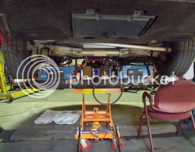

Big update time!

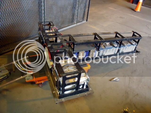

Today was the day to get the capacitor bank installed, and everything all buttoned up. The control panel and all the other bells and whistles (DC/DC converter, high voltage monitor wires, coolant for motor/controller, power steering fluid, windshield wiper fluid, etc.) we all taken care of. One thing I had to do in order to make sure the coolant system was leak-free was to remove the inductive charging unit:

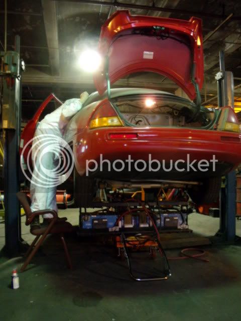

It was just extra weight anyway, and came off pretty easily. I had convinced the folks who run the university's garage that I needed to use the lift, and this morning Eric Cardwell (we met at a meeting for EVA/DC where I gave a presentation about the EV-1 conversion project last winter) came by and we got things rolling. Once the car was pushed to the lift area, we loaded the capacitor tray onto a lift table and wheeled it over there. This little table ended up being quite handy.
Eric worked the heavy (4/0) cable, which will be run to the generator, up from the tray and back into the trunk via a couple of holes punched in the frame. The second image below shows the lift table being used to line up the tray with the car's cavity.
We eventually got it into place and we worked pretty hard for over an hour getting everything mostly aligned. We re-installed the bolts into the tray and secured it into place. The air shields still need to go on, but that can wait.
