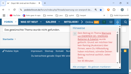

i made identical post to this web site you pointed to me and they wouldnt let me post it and put me 45min suspension, the reason was they dont want any stupidity?? from any firm? and i should write objectively, well before i made this post which is identical what is here but translated by chat gpt to german, i asked chat gpt to translate my writing to suitable form with good manners, i really dont know how can i write more objectively as i only state the facts and say that this has caused me lot of problems running my errands, maybe you could say better than google translate whats its all about? or maybe you could point me to another popular german ebike forum, iv tried to find more but it is very slow because of the translation even navigate forward in the site, i literally have to google every word on action buttons on forums and some sites seems to be almost dead.
Ranting verboten!
Honestly, you were ranting about the supplier, now you're ranting about the .De forum. You didn't really thank anybody here for the help they gave you. There's even indications of deriding it. Nobody is going to have sympathy for you, other than for your lack of being able to deal with problems in a rational way. My advice is to read what people wrote and try to understand it. Ask questions if you don't understand what they're saying instead of telling them useless facts.
Ranting verboten!
i want to know how is my post ranting? in my opinion i posted facts what have happened as symptoms of the malfunctions battery, what kind of service i got from the supplier, reasons why i think it was malfunctioning and end result of trying to get new one from warranty, there is not much in the post else then saying im frustrated, thats hardly "ranting" and not thankin people is not true, i´v got several helpfull messages and i´v thank people who have helped me, i´m not going to thank people who claims against every data given from suplier other people in several ebike and ev forums who also stated that 50v end charge voltage is not normal for this battery also iv checked the math by A.I also. and im not here for sympathy, im here to warn people of their customer service and your writing tone as "nobody" "honestly"gives me impression that you are biased, how you can speak behalv everybody in the forum? and how i act irrational?? dont you think suplier should replace their products if they come to me as not working as advertized and its been four months from this, dont you think i should warn other people of their email ignorong and slow customer support?
if you refer of the voltage measured after charging then even the supplier dont agree with you, because its the reason why they took it for repair in first place, what wouldnt happen if would be normal to have 50.3 volts, and they told me this too, i guess you know better than people who make their battery.. maybe you have reading disability or something but my post have many times stated that in current state of battery is dead, i cannot get any reading from it from multimeter, nor the bms indicator seem to work and when hooked to ebike the ebike wont turn on, i cannot open the battery and remove the heat shrink around it because it will avoid the warranty, and not going to measure voltage from charging side as it has risk of damage the battery, all i can do is measure it from output side and as i told before i did not get any reading, today i got answer that they are waiting for response from their techician as eight days later when i again contacted them, if you have read european consumer laws you would know that their response time, repairing faulty battery instead handling that their own time and giving me replacement is against law, customer laws state that i should get refund or same kind of product with out delays, dont you think breaking consumer laws not worth notifying other people? should i just take loss of 420€ and start fiddling with battery what is under warranty? and loose my consumer rights? your being unnecessary rude, giving false info and it pretty much feels like trolling.
give example of ranting from my post and give me example how should edit my text because your writing are unhelpfull, your writing does not have any facts, any data any constructive critisim and it dont contribute to the post or the topic anyway, if you dont have anything else to say than personal attacks, stay out from other peoples post´s
Write in english on pedalec.de, it would be polite to apologise for your language ignorance or at least acknowledge it, but most Germans who contribute online are way more competent with english than we english speakers are with German for the most part at least.
i want to know how is my post ranting? in my opinion i posted facts what have happened as symptoms of the malfunctions battery, what kind of service i got from the supplier, i´v got several helpfull messages and i´v thank people who have helped me, i´m not going to thank people who claims against every data given from suplier other people in several ebike and ev forums who also stated that 50v end charge voltage is not normal for this battery also iv checked the math by A.I also. and im not here for sympathy, im here to warn people of their customer service and your writing tone as "nobody" "honestly"gives me impression that you are biased, how you can speak behalv everybody in the forum? and how i act irrational?? dont you think suplier should replace their products if they come to me as not working as advertized and its been four months from this. if you refer of the voltage measured after charging then even the supplier dont agree with you, because its the reason why they took it for repair in first place, what wouldnt happen if would be normal to have 50.3 volts, and they told me this too, i guess you know better than people who make their battery.. maybe you have reading disability or something but my post have many times stated that in current state of battery is dead, i cannot get any reading from it from multimeter, nor the bms indicator seem to work and when hooked to ebike the ebike wont turn on, today i got answer that they are witing for response from their techician as eight days later when i again contacted them, if you have read european consumer laws you would know that their response time, repairing faulty battery instead handling that their own time and giving me replacement is against law, your being unnecessary rude, giving false info and it pretty much feels like trolling.
give example of ranting from my post and give me example how should edit my txt because your writing are unhelpfull, your writing does not have any facts, any data any constructive critisim and it dont contribute to the post or the topic anyway, if you dont have anything else to say than personal attacks, stay out from other peoples post´s
AI output is banned in here so it may simply be banned from pedalec.de and your translation probably has a lot of tell tale give-aways picked up by a batch filter or bot or ai agent.. How did the English non ai translation from the AI german read?
why is AI output banned here? i write the text and asked AI to fill any grammar errors and make it on form its easy to read. or are you talking about the calculations of the battery pack?
Here's the definition of rant. To me, it seems to fit pretty well with what you wrote. What do you think?
i think they took my message as ranting, but im trying to figure out why, i understand it might hurt enerdan.de someway posting messages what can make them seen as negative way, but as i read it over and over again, i never said they are scammers or trying to rob me or that intentionally send me broken product or anything like this, in my opinion i have just stated exactly what have happened, i´v ask people who claim im ranting to point the exact words what makes my post ranting instead of listing facts, i would like some so i could edit the txt in the form that i could post it to the pedelec.de but i dont know what to edit.

i think ranting dont have anything to do with my original post, i allready told this. copy paste section what you think is ranting and if it includes facts what have happened, maybe you can tell me how i could edit to be not ranting anymore but still giving all the same information, like example how you would rephrase it instead.
yes im not angry or shouting or speaking impassioned way, so im not ranting. i am frustrated and giving all the facts revolving the battery and the customer support. warning other people for this is not ranting.
That's strange because that's not the way I see it, and neither is it the way the German forum sees it. Still, you haven't taken onboard any of the help or advice you've been given, both regarding how to get your battery fixed and how to persuade people to help you. You're just going in deeper. I'm trying to help you, but it's very difficult when you don't co-operate.

yeah, now i understand its about spamming and creating messages and threads, i dont think this applyes for using chat gpt as help forming the message and then posting by real person. no AI were used in this site it was done outside this site and then just copy pasting text like i did on the pedelecs.de forum, they have no idea was the text spell checked by AI in different web site or not, words are my own but spelling mistakes and chaptering was done by chat gpt, except the battery calculations what was only posted in this website, they were done by AI but in different web site than here and result were just copy pasted, as another words i did not bring AI with me :)
