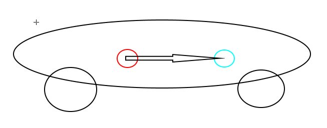

Here is how I see it (let us assume that bike has exactly zero mechanical trail and the rider does not try and correct for anything):
Here is a sketch of a fully-faired bicycle (Center of pressure is blue, center of gravity is red):
Let's assume they are on the same height, but there is a considerable lever arm betwen CG and CP, therefore side wind will cause the bike mostly to *yaw* away from direction from the wind due to side force at contact patches causes 'self-steer', which in turn will cause centrifugal force toppling the bike *into* the wind - which is likely a good thing I guess? Or maybe not?

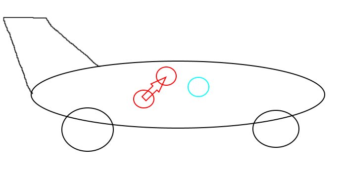

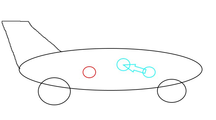

Let's add huge-arse vertical stabiliser:
So, CP is shifted back and up now, which imply that 'direction change' is now less, is more likely NOT to overcompensate wind toppling. Maybe. Really hard to ascertain without doing a lot of experiments.
Alternatively (which is easier on e-bike due to compact, but heavy battery) you can move 'ballast' around, play with body position of the rider (which is heaviest piece of 'ballast' on e-bike) to bring CG closer to CP both vertically and longitudinally.
All in all, if you want fairings on your bike, you want a combination of front and rear fairings not just for aerodynamics, but actual handling reasons - 'dustbin fairings' were banned for a reason, and while you want lateral area as small as possible, having it 'unbalanced' is worse.
