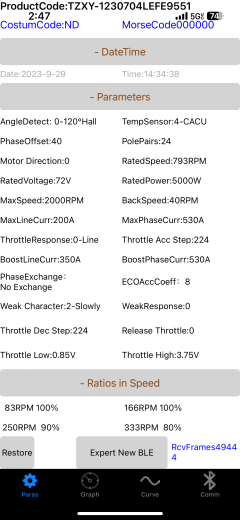

i’ve tired to setup the flux weaking and it seems to make no difference in speed, i’m only doing 49 when the battery is rated for 18kw. thank you in advance. i’ve attached my settings below.

The fardrivers enters flux weakening automatically, I have not found a option to turn it completly off
raisse the limit speed from 1000 to 1400
and raise the % at 1166 to 33%
and show us the rest of the settings

i’m not trying to turn it off, i just want more speed :). i’ll try those settings soon. what other settings do you wanna see
At keast battery current and phase current settings on the first page.
I know that you do not want to turn the flux weakening off, but it would be nice to see how much the flux weakening can raise the top speed.
My scooter was 103kph with Sabvoton SVMC72150 without fw activated, now with the fardriver I have to limit to 115kph to not risk to overheat the motor to fast. 120-125kph seems to be possible now with enough fw.

it also seems like whenever i change a setting it reverts back to how it was
Did you save after changing settings?
Or the setting is over the max allowed value. But in the ratios of gear there is up to 100% at ecery rpm possible.

i set a few to 100, and then just turn my phone off, when i go to check the settings an hour later after riding it, the settings are back to stock. i don’t see a save button on my app anywhere.

i found how to fix it in the fb fardriver group, can you show me your settings on your fardriver? similar motor? now with a little of my own tuning i’m seeing 65 at 150 line amps 450 phase
I have a QS60V5000W 260 40h motor with uprated phasewires to 16mm² with 205°C , my scooter weights 183kg without me.

You have set the ratios in speed to higher values.
I would also check the value weak response

heres my current settings

The ratios on speed are still on the same settings the controller does during the auto learn.
You have to raise them, just look at my Screenshots.
I would ad 30% to every value up to 1000rpm, and you raise your speed. Just look at my setting, on road I drive up to 1500rpm.

i have a hub motor, no matter the settings im never seeing past 760 rpm. and those field weaking settings are my own i set them but whatever way i put it my speed or acceleration doesn’t change.
