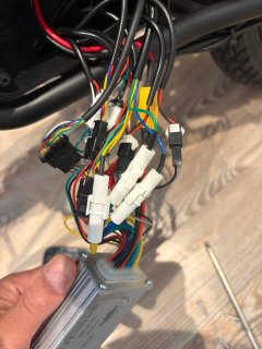

If you look at your bundle of wires, you might see a single wire come out to a connector and go back into the controller. That's often a speed limiter circuit on many controllers, including some KT. Just open the connector. See if the bike still runs,a d iff it runs any faster,
No cable like that one you said in my controller

You can buy connectors with pigtail cables on them and splice them in with butt connectors or solder and heat shrink tubing. Grin sells a small form factor controller called the Baserrunner that can be combined with either their Superharness and color display or with a CAv3. It works with multiple voltages, torque sensors, PAS, throttles, ebrakes, etc.

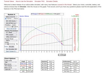

A 500W controller probably won't get you to 25 mph, but you can give it a try. That's about the same as your current controller (36V X 15A = 540W). I am not sure what motor you have, but you can play with the motor simulator to see what combination might work for you:
Grin Motor Simulator
