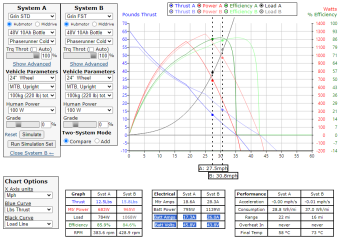

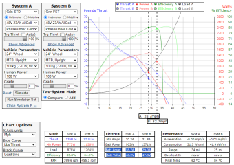

You can get a good idea of the relationships by choosing a fast and slow wind motor of the same model in the Grin simulator, and running a scenario on flat ground, then with a light grade (say 3%) to see the performance and how quickly they overheat on a grade. The G020 isn’t modeled, but you can use another geared motor just to see the impact of a slow vs fast winding. Using the G01 as an example, the fast wind will be faster, but at the same speed will overheat a little more quickly on a climb.
I’m not on my laptop, or I’d send a link of the two modeled, but here’s a link to the simulator (it’s worthwhile to read the whole page and get familiar with the simulator, since it’s surprisingly accurate when replicating the test conditions in real life.
The fast wind will consume 15-40% more amps, you'll need a heavier duty battery to feed one properly, otherwise the result will be a lot of voltage sag.
Like above, play with the motor simulator, it can teach you a lot.

Thanks for the responses. I did play around with the simulator before posting this. I found that differences between the std and fast wind can be significant different depending on the motor. I will go back and play with it some more.

The motors will reach maximum efficiency at different speeds due to their wind, so you need to specify for comparison, if you mean when both are running the same speed (and what speed), both WOT, or something else. If you are riding with your wife, maybe model the speeds you would ride together at first. I would try to stick with a bafang motor for modeling since fast vs std may be more similar than how another defines fast or std. Or, you could research your motor specs and try to find something close, but that’s looking at a lot of spec sheets.
Continue to play with the ebikes.ca simulator, it's super useful. :)
