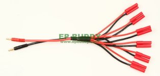

I love this balance extension/adapter sold by EP Buddy;
It's for charging, not discharging, but with it's 12 AWG common wire, it's heavy enough up to 14S to use to discharge.
On a 12S system, you pair two 6s's in series as your basic building blocks giving you 12S/5Ah. Then using that cable to parallel to 12S/10Ah, 15Ah, etc.
Very simple and you will still have an empty pair of connectors to bulk charge.
If you decide to use more than 14S, it would be better to parallel the 6S bricks first, then series. No 14 AWG anywhere[at least 12AWG] and that stuff you would need to make from scratch.
