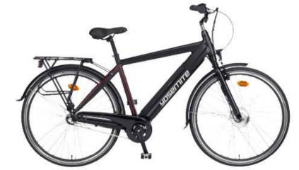

Hello
I'm kind of stuck with an ebike frame and no clean options for rear drive hub motors. The frame has 120 mm dropouts and that eliminates practically all hubs I've seen online. I've heard that the Q hubs can be adapted to 120 mm but they're also geared hubs which lack any regen capability from the factory. The main reason for this is that the frame previously relied on internal rear wheel hub braking and lacks any proper mounting hardware for external brakes and I would want a hub that can at least somewhat slow the bike in addition to the front hydraulic brakes.
Are there any viable stock DD options that can fit into 120 mm or am I only left with machining shafts or modifying geared hubs?
Thank you

What kind of bike is it?
It’s a 36V system with a 9A rated (18A max) Lishui controller. Originally a front hub motor setup, but I'm switching to a rear hub as part of a general upgrade/repair
