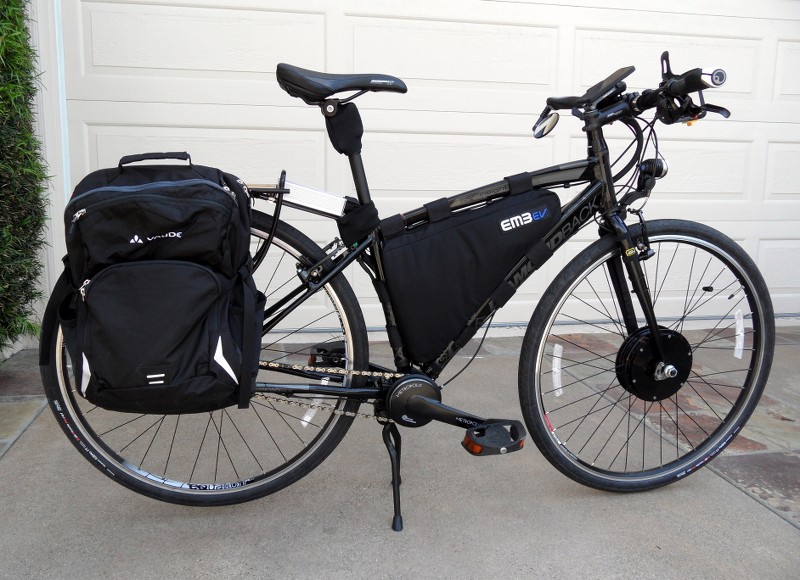

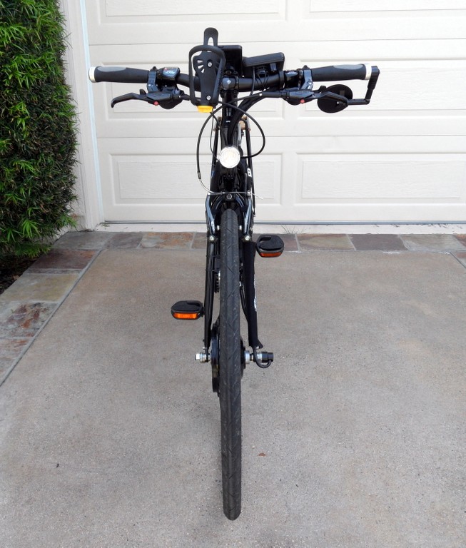

This is my entry into E-biking. I've been commuting on this for three weeks now, and don't think I could be happier.
The base bike is a 2012 Diamondback Insight STI-8 hybrid: http://www.diamondback.com/2012-insight-sti-8 I didn't have an e-bike in mind when I bought it. Before deciding on the conversion, I had performed a few upgrades, including:
With the 8 speed Alfine IGH and Patterson transmission, my only real option was a front hub motor. I decided on MAC 10T, and ordered the front wheel and 50V, 12.3AH NCM triangle battery from Cellman. I decided to try to pair them with the BMSBattery S12S 12 FET Torque Simulation Sine Wave controller, and an LCD1 display. My plan was to try this controller first, since it promised the features I wanted, and only costs $60. If it didn't work, I would fall back on the Infineon controller, with CA.
It turns out that the MAC motor/S12S controller pairing is a dream...Extremely smooth and quiet. And since I wanted my build to be strictly PAS driven, without a throttle, the functionality is ideal.

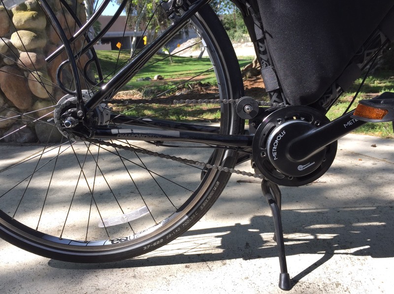

The drivetrain:
After my first few rides, I realized that this setup was faster than expected. So I changed out the rear sprocket for a 16 tooth, the smallest that can be fit on the Alfine 8. Now the top drive ratio provides 123.4 gear inches, which is the same as a conventional 50t crank with an 11t sprocket. And the gearing is wide enough to get me home if something goes wrong with the motor.

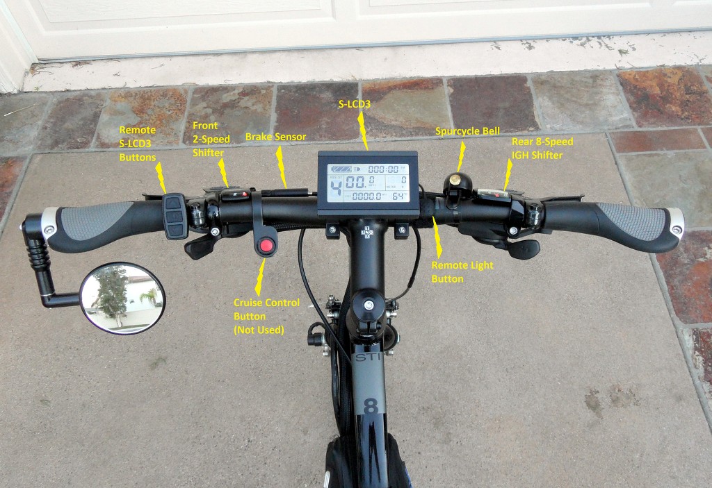

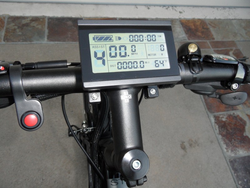

The cockpit, with Mirrycle Mountain mirror, LCD1 display, extraneous on/off switch (planned for cruise control, which is not supported without a throttle), Topeak phone mount, remote light switch, and obligatory commuter cup holder :wink:

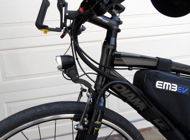

The head light is a Magicshine, which I modified by adding a remote handlebar switch. For the rear, I'm using a European dynamo taillight with a stand light feature. Because I wanted it to blink, I removed the stand light capacitor. The head and tail lights are wired to the main battery through a DC down converter, and a Solid State Relay which is switched from the 5V throttle source (since I don't use a throttle). So the power to the lights come on with the controller, with the on/off button on the LCD. The taillight is wired with one of those $2 inline LED programmable blinker modules.

The business end...
I had fitted the motor to the stock aluminum fork...But then read enough on this forum to realize that would end in disaster. So I replaced the fork with a Tange CrMo model, and used two torque arms. I'm feeling much more confident now.

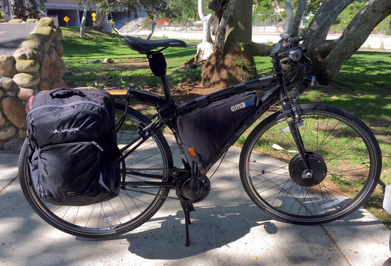

My objective was to build something which would make my 9 mile (one way) commute fun, and encourage me to keep with it. And it had to provide some degree of exercise - preferably capable of getting me to work without a heavy sweat, but where I could put in more effort if desired.
This bike hits those targets on the head. I can keep at least light resistance on the pedals in all but the top PAS level. Level 4 of 5 is where I spend most of my time. It's good from about 25-28 mph on the flats. Level 5 brings the speed up around 34-35 on the flats, which is faster than I can pedal with effort. The PAS give a true bike feel...I have to downshift when I stop, so I can rebuild momentum while the motor kicks in. (Bike weight is about 60 lbs, even.)
I'm adding a watt meter next week, so I can get some idea about where I stand with max Amps and battery usage over my commute.
