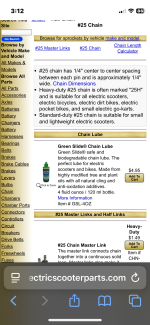

a 126t using a #25 chain sounds reasonable and it’s got a 1/4” pitch vs a common 8-speed chain with 1/2” pitch. So half the diameter. I use 70t with 8-speed chains and that’s commonly done. Better yet do a 140 or 150t and also increase the motor sprocket teeth count a couple .. but that’s a guess and I’d do the freewheeling cranks n jackshaft.
Auh... nope. #25 won't last, he'll need #25H at a minimum. And that's even marginal considering 3kW pulling on it.
I’ve never tried #25h size but seems commonly used for powered vehicles
It generally shows 1/3 the strength of an 8-speed chain (#40).
Or could use #35.
Or could use #35.
Bicycle chain has an extraordinary high strength to weight ratio compared to industrial chain.
Also consider bike chains are designed to operate at much lower RPM.

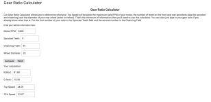

Thunderstruck Calculator
Beware, sprocket terminology is confusing.
"Sprocket teeth' should be "motor teeth"
Chainring teeth" should be "drive wheel teeth"
enjoy
